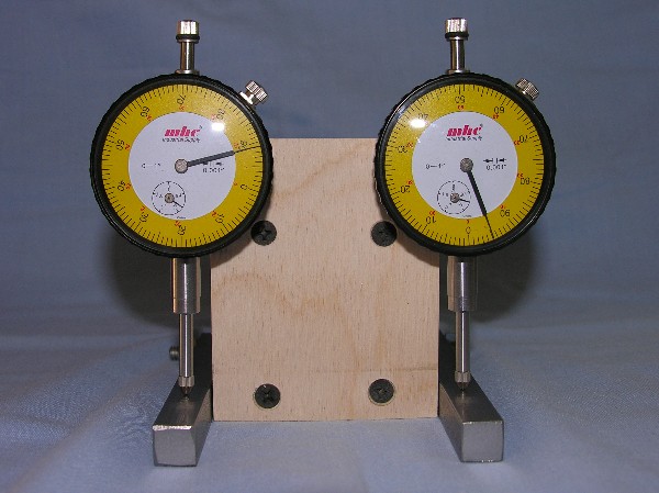

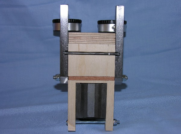

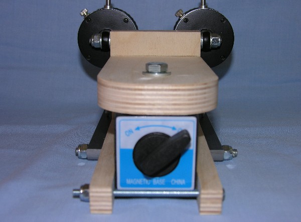

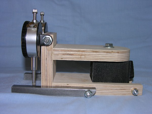

I just wanted to say thanks for the jointer knife setting jig plans. I have always set mine the old way, but your jig seemed like it would be fun to build. I apologize for taking a few liberties with your design. The jig seems to be accurate down to .001. I don't know if I will give up my old method, but will give this thing a good try. I should point out, this entire jig was built with the SS 500. It would be nice if more folks posted pics of their jigs and fixtures they have made.

I've gone online and found several magnetic bases for sale. Some have 44# holding power, some more.
How lbs holding power is recommended for this jig?

As much as you can afford.

robertshafer wrote:I've gone online and found several magnetic bases for sale. Some have 44# holding power, some more.
Thanks,
RAS
RAS,
Take a look at what the ENCO Company has to offer. They offer inexpensive odds and ends for the machine shop and are great folks to deal with.
