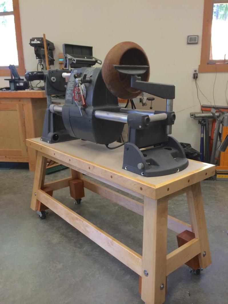

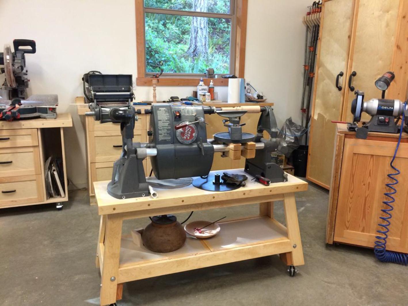

I have found the SS too low for any in-depth turning. Over the years I managed with short term projects, but know I am beginning to turn more. I tried raising the SS but it was difficult to manage and can become a little top heavy. I upgraded to the Mark Pro a few years ago and therefore had a spare SS standard motor I made a stand for it and found this to be a real plus in my shop. Not only do I use it for lathe turning but also as an auxiliary stand, I still do a lot of flat work. The metal tubing I bought from the Metal Supermarket for $20.00. In summary it was just too much effort to raise the SS when I wanted to turn and then have it ready for my other projects.

Old Salty
Bronze Member
Posts: 2
Joined: Sun May 22, 2011 11:37 pm
Re: Lathe Height
Post by Old Salty »
Maybe a few pictures would help

Post by algale »
Pretty slick! And I've never seen anyone put the tool rest in the base arm like that in order to get a better angle for bowl work.
