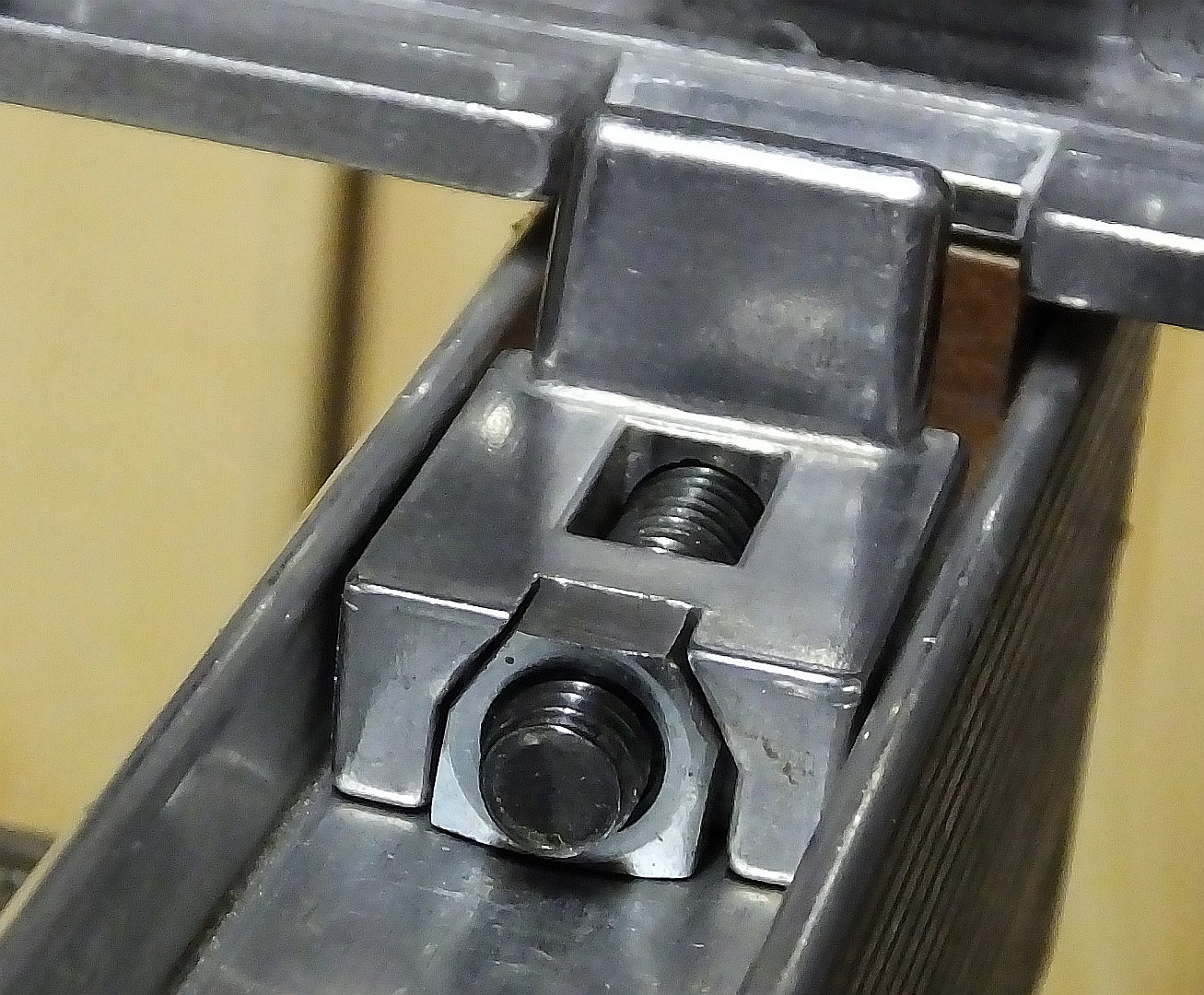

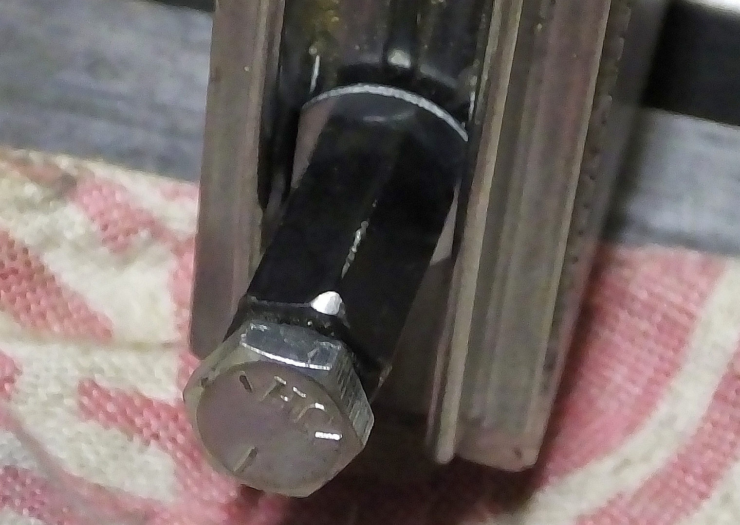

I went back to the bandsaw upgrade fence today. I am now satisfied with it.
I made two new parts for it.
bandsaw fence mod 2 parts.jpg (1.09 MiB) Viewed 8428 times
now the clamp nest shape makes sense.
bandsaw fence mod 2 nut.jpg (1.08 MiB) Viewed 8428 times
And the washer slides on the two raised edges better than the nut/coupler.
bandsaw fence mod 2 washer.jpg (1.17 MiB) Viewed 8428 times
