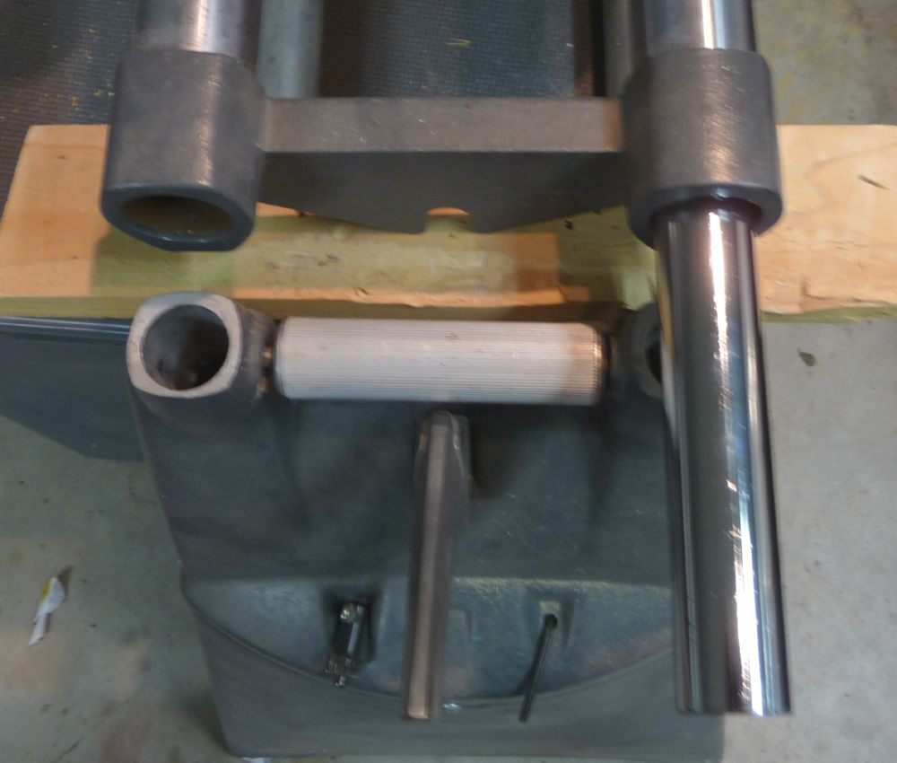

I ran across a 72" heavy duty closet rod yesterday that was only 55". Someone had cut of a section (quite smoothly) and returned it for a refund. HD sold it to me for $10. I cut it to fit inside the way tube and wrapped duck tape 12" from the end so I can pull it out to the tape and raise the headstock to upright.

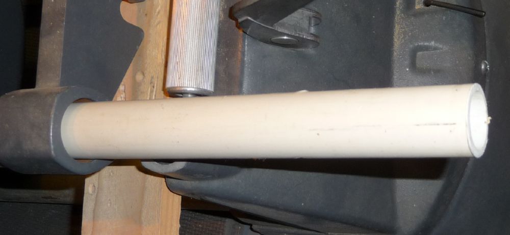

I also think thick walled PVC pipe will work but will leave it up to the engineers to determine if it will meet the stress test.
- PCV.jpg (59.41 KiB) Viewed 1801 times
