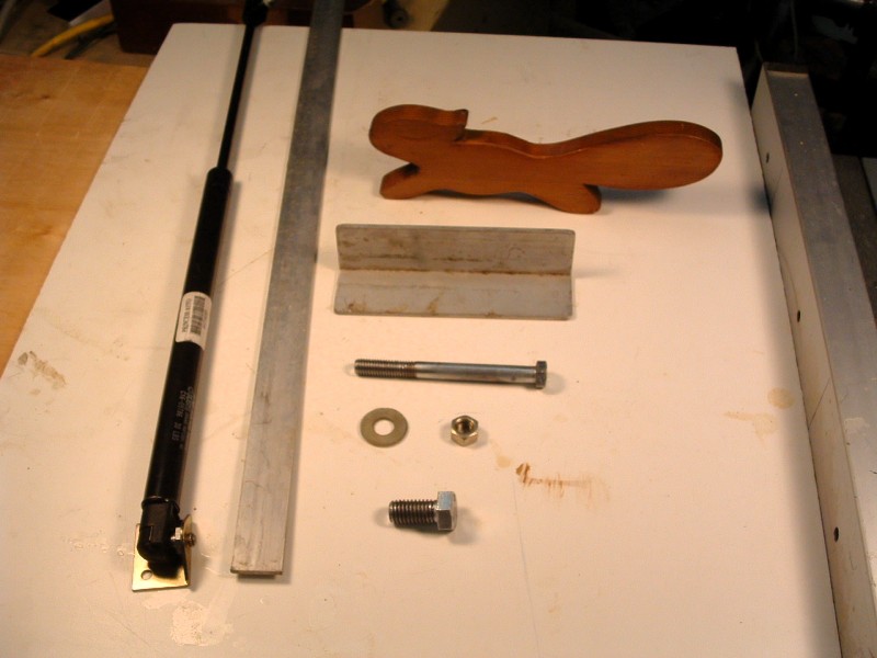

One of my 10ERs is permanently in drill press mode, it works great but the table was hard to adjust up and down.
Last year I picked up a gas lift support at Princess Auto (like Harbour Freight), reg. $9.99, on sale $6.99 :) , and wedged it between the base and the carriage. Gas Shock
This has worked well, it will hold the table in place with the lock released and can be moved up or down quite easily.

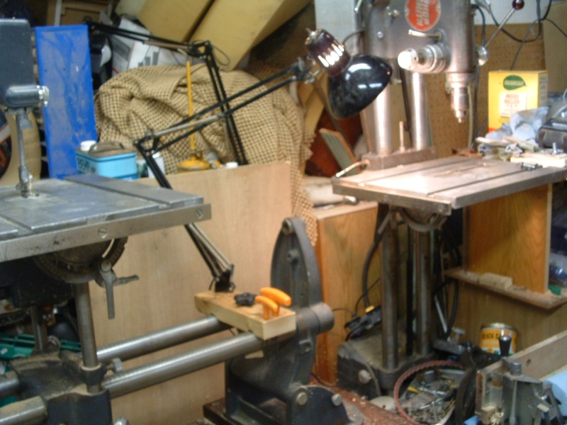

I'm not sure if any one noticed but it actually showed up in a photo I posted last week, Clamp on base for my work lamp.(first post third photo).
I'll re-post it here.
This weekends project was to mount it permanently.
Here is what I started with.
drill table lift parts1.JPG (75.88 KiB) Viewed 9341 times

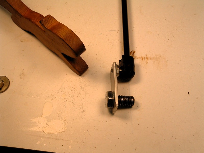

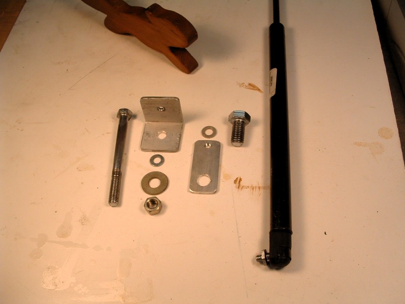

Mounting brackets made:
drill table lift parts2.JPG (71.04 KiB) Viewed 9341 times
left to right
3/8" x16 UNC bolt and nut - this one is too long , 3" would be better
lower bracket - 1 1/2" of 1 1/2"x1 1/2"x1/8" aluminum angle with 3/8" hole and 13/16 hole threaded 1/4-16. edit: should read 13/64 hole threaded 1/4-20.
upper bracket - 2 1/4" of 1"x1/8" aluminum bar with 1/2" hole and 13/16 hole threaded 1/4-16. edit: should read 13/64 hole threaded 1/4-20.
1/2"x13 UNC 1" bolt
lift support (30lb lift)
Upper bracket assembled

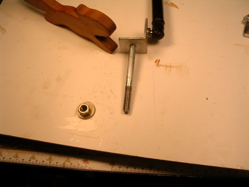

Lower bracket assembled
drill table lift lwr assembly.JPG (74.33 KiB) Viewed 9341 times

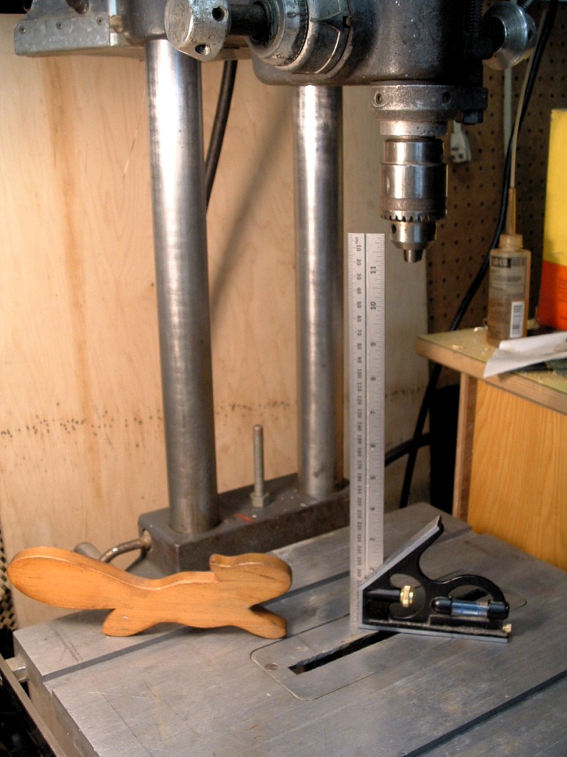

Here it is installed
drill table lift installed no table.JPG (179.91 KiB) Viewed 9337 times
With the table at its lowest
drill table lift with table lowest.JPG (168.1 KiB) Viewed 9337 times
And the table at its highest
drill table lift with table highest.JPG (159.63 KiB) Viewed 9337 times
