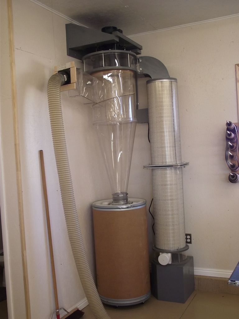

WoW, I guess that is an old Performax. I have never seen one like that. I have a 16/32 that I bought new a few years before they stopped making that name in favor of the Jet (same sander same company). My JDS 1.5 HP DC with a 1 micron canister filter worked fine with the Performax. Now that I have a Clearvue Max at 5 HP and almost 2000 CFM it is a no brainer. NO dust escapes.

For that to happen someone would have to figure how to fit me in a 4" dust hose. Not likely. :D
When I finally get it plumbed in it will have an 8" main line, 6" drops and 4" flex lines to the tools.
