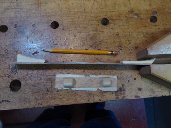

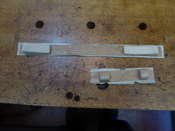

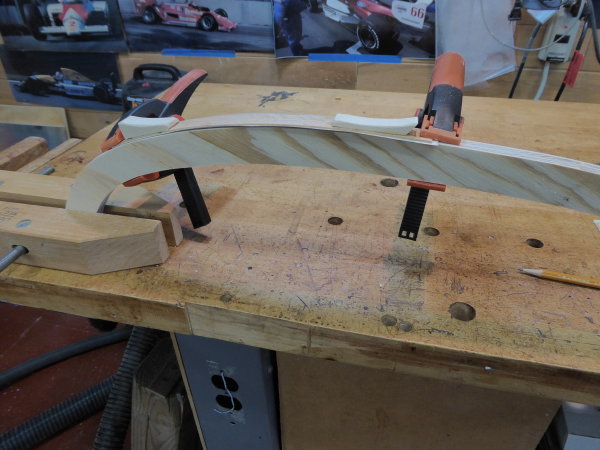

I think I have the sanding - smoothing sorted out. From somewhere in the depths of memory I remembered this idea. (I think it came from Woodsmith or ShopNotes.)
I made these flexible sanders. A very thin piece of stock, one which can conform to the general shape of the curve, a couple of handles on one side and sand paper on the working side. Here are 3 pics. I the one I have clamps holding the sander in position to demonstrate how it conforms to the curve. The shorter tool is for the tighter radius of course.
