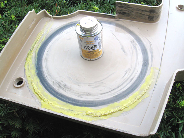

Here is a post I had awhile back on this subject:
http://www.shopsmith.net/forums/showthr ... ver+repair
[ATTACH]27014[/ATTACH]
Repair worked and that band saw was sold and I kept a newer one.
- repaired cover.jpg (93.29 KiB) Viewed 3320 times
Peter
