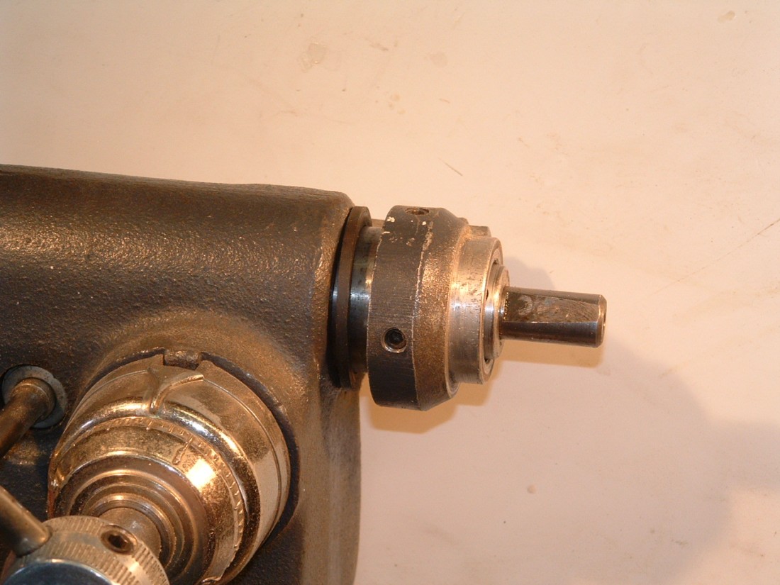

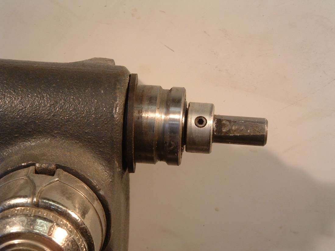

There is an aluminum collar that goes on the shaft and holds the inner race of the bearing in place on the shaft.
Shaft bearing retainer.JPG (158.53 KiB) Viewed 3061 times
Also, advance the quill a bit and lock it in place before mounting the depth stop collar on the quill.
This makes it easier to get the collar on properly so that the set screws register in the groove on the quill.
The inner side of the depth stop collar holds the outer bearing race against the quill and this minimizes end play.
Depth stop collar.JPG (165.19 KiB) Viewed 3061 times

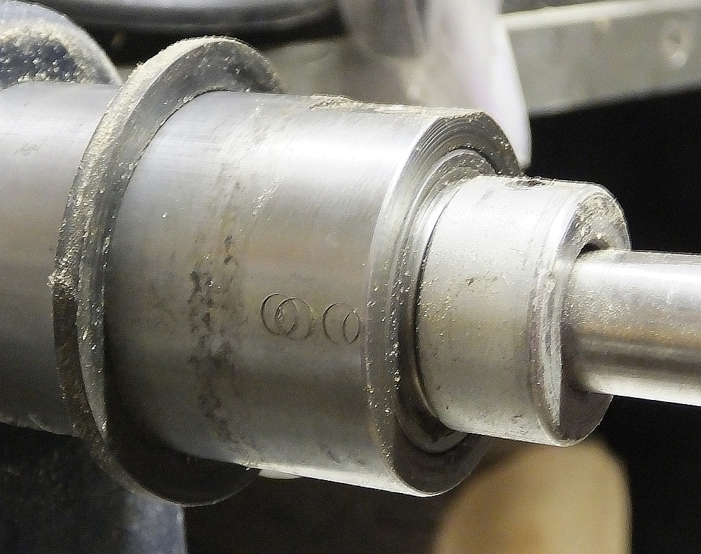

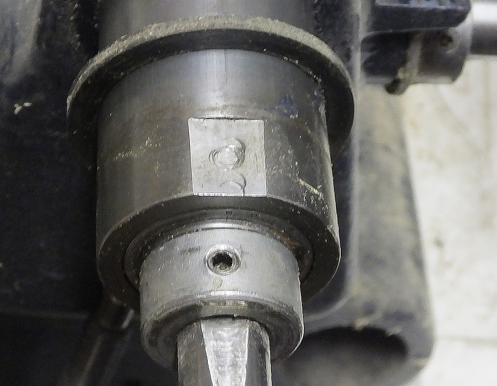

QUILL ALA 10E
10E QUILL TOP.jpg (681.82 KiB) Viewed 3012 times
10E QUILL SIDE.jpg (699.48 KiB) Viewed 3012 times
Align/tighten the top on the flat first, then tighten the side set screw.
Notice the stop collar is there.
The quill stop bracket must clear the stop collar.

Sorry, I had forgotten there were slightly different quills but the one on my 10er dedicated drill press is like the JPG posted (no groove).
That is not a big deal though.
If you can see the bearing from the end then the small retaining collar is not in place.
And do extend the quill a bit when seating the collar attached to the stop rod, if it doesn’t seat properly you will get a lot of end play.
Don't ask how I know. :o
