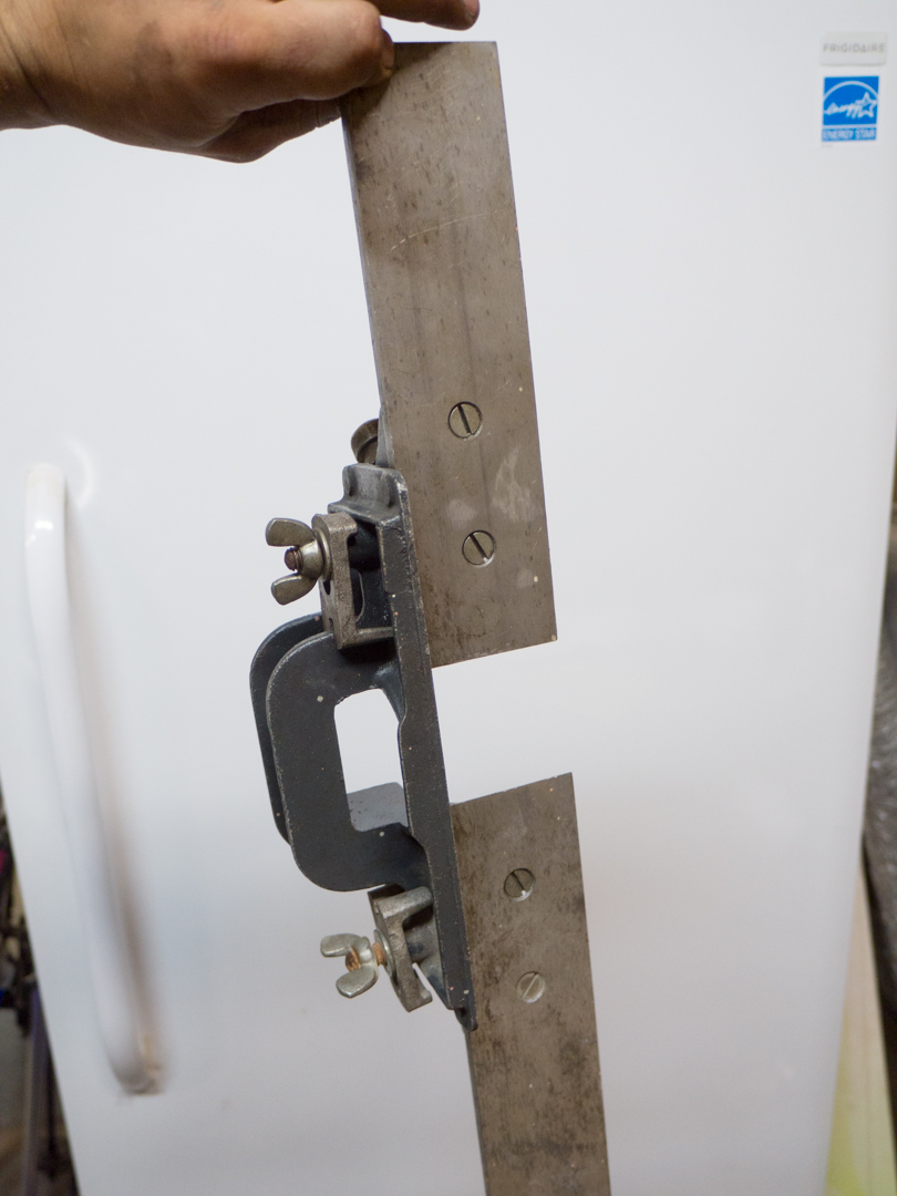

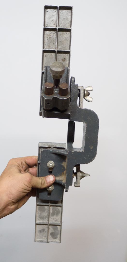

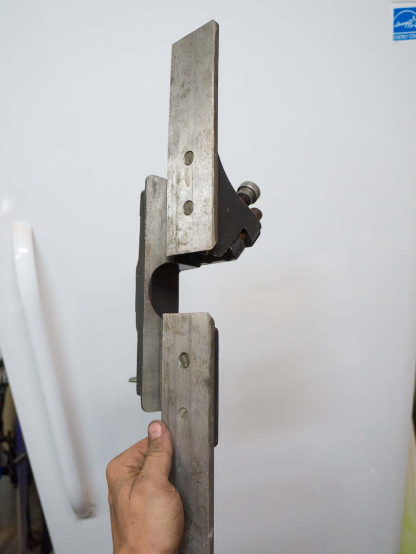

Hello,
In my recent acquisition of Mark VII with half a Mark V headstock and the Mark VII reversible motor as well as a spare Greenie that had already been pilfered in the past, I also received a pile of add-ons.
All are easily recognizable in the manuals (I have the Mark V and Mark VII parts manual and owners manual), however one remains elusive.
It is quite possible it isn't even for the Shopsmith. If it is, I have seen no mention of it.
Depending on how it mounts, it would work like a jointer, with the knob slowing lowering the indeed 'table' side.
Here are the pictures, any thoughts?

It looks like a jointer-shaper fence for 10ER

eartigas wrote:It looks like a jointer-shaper fence for 10ER
Looks like you're right! Never know what surprises you'll find in a box of parts. The seller said it was the router fence...Which was not actually included
