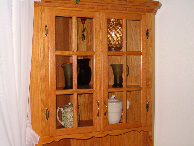

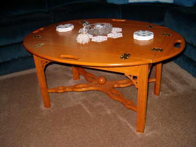

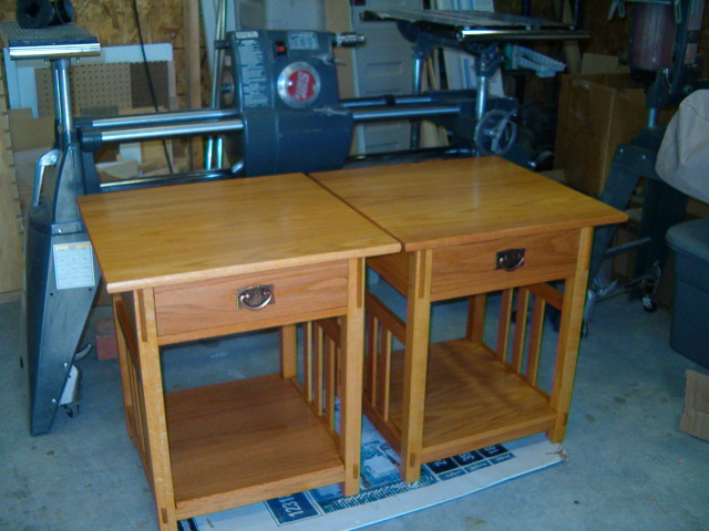

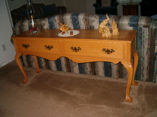

Since you asked - here are 5 projects. The forum will only allow 5 photos with a post. (you can also click on my avatar)
There are a lot more photos of really pretty items folks have made. Maybe some of the folks will give you a link to them.
[ATTACH]1776[/ATTACH]
[ATTACH]1777[/ATTACH]
[ATTACH]1779[/ATTACH]
[ATTACH]1780[/ATTACH]
[ATTACH]1781[/ATTACH]
- HPIM1335.jpg (119.99 KiB) Viewed 33163 times
- HPIM1336.jpg (136.35 KiB) Viewed 33163 times
- two on 11-10-07.jpg (125.13 KiB) Viewed 33154 times
- HPIM1766.jpg (133.66 KiB) Viewed 33150 times
- HPIM1505.jpg (101.84 KiB) Viewed 33149 times
