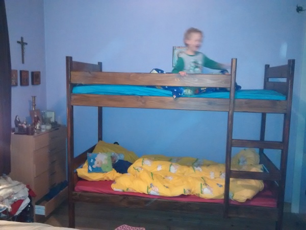

This is my first real project using mostly the Shopsmith.
Finished bunk beds
Finished bunk beds

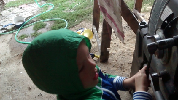

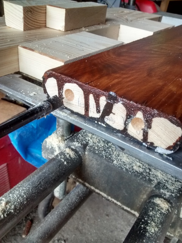

The boards (siberian spruce) came planed. Used the shaper for rounding the edges, ripped a couple of boards, disc-sander in a few places, and drilled all the dowels using the horizontal drill press mode.
For the latter my four year old son helped me-- I held the boards in place while he pulled the handle to drill the holes.
I used spacer blocks to repeatable offset dowel holes on 30mm centers.

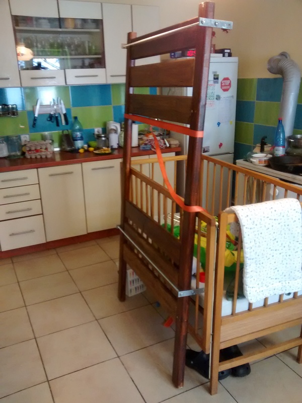

I didn't have a wide enough clamp to hold the headboards together while the glue on the dowels dried, so I made two using threaded rod and some flat bar as well as a tie-down strap.
the threaded rod touched the wood in some places and left marks.  if I were doing it again and concerned about the marks, I would slip vinyl tubing over the threaded rods.

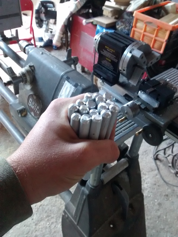

The only non-shopsmith stationary tool used was a miter saw to cut the boards to length. As well, I used my Taig lathe to round the ends of 4 inch 10mm diameter aluminium "dowels" I made for supporting the bed-frame rails as I want it to be possible to take apart but I felt like unglued 1-3/4 inch dowels would not be enough there.
Taig lathe "SPT"
Taig lathe "SPT"

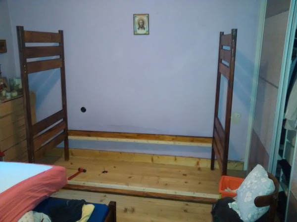

assembling it in the room.  a machine screw grabs into a cylinder nut in each frame rail to hold it together

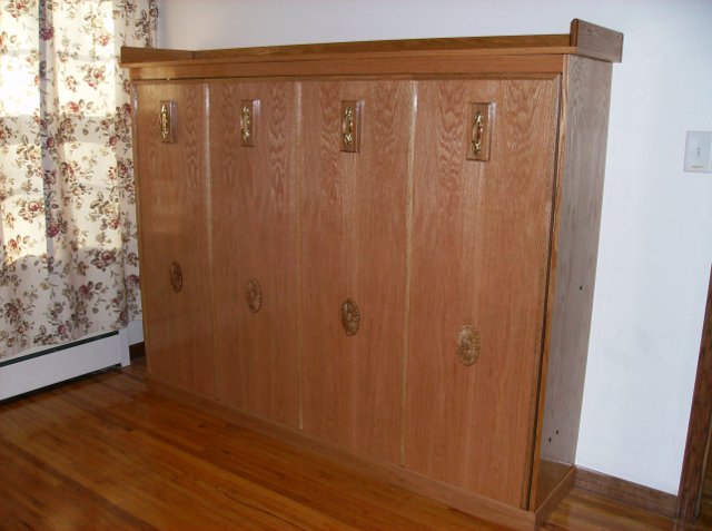

That is a nicely done project and so useful. A few years ago I built a wallbed in our spare bedroom. The room is seldom used as a bedroom and our house is small so my Wife wanted to be able to use the room for a sewing room most of the time. Replacing the old standard bed with a folding wall bed effective gave us an extra room and at a far lower cost than adding onto the house to get that extra room.

The wall bed I built uses a hardware kit from Rockler.
http://www.rockler.com/side-mount-murph ... elect-size
The finished bed can be whatever design you want using the plans that come with the hardware kit. I built mine like the attached photo.
