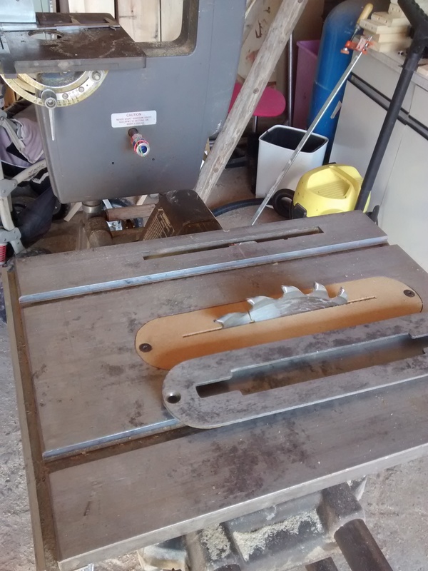

I got the ZCI made. Unlike with the cheap hand jig-saw I have, I was able to cut the curves perfectly (even though it has a 1/2" blade on it).
Zero clearance insert installed!

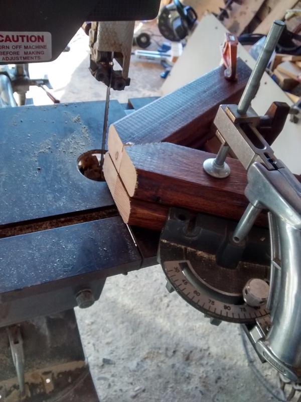

This allowed me to safely cut the different angles for the legs on the table saw. I changed the angle of the legs with respect to the floor (I had first cut at 70°, but then I realized that some corresponding drilling and cutting operations needed 20° which isn't possible with the miter gauge, so I re-cut at 60°) and this recutting I didn't get all the pieces the same length. After gluing up the two sides I saw this error, and was able to use the band saw to safely trim them to be the same.
Trimming top of stool legs to be equal height.

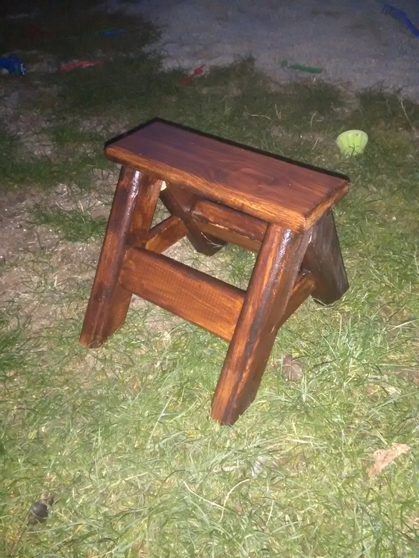

End result of project that necessitated these operations:
Finished stool
Finished stool
The legs still didn't come out perfectly, I made some mistake with dowel holes, I guess, but my kids didn't notice.
