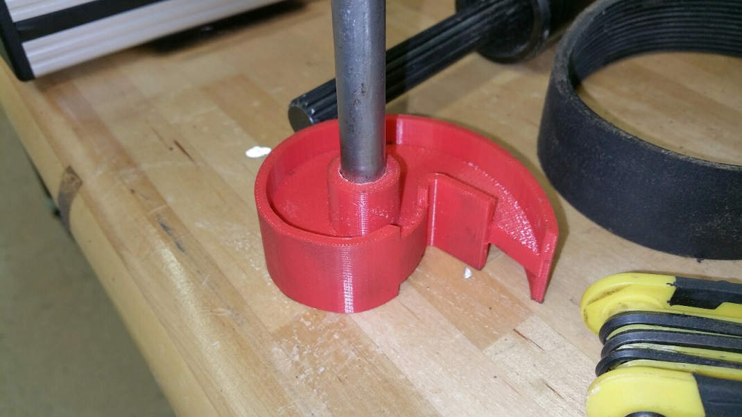

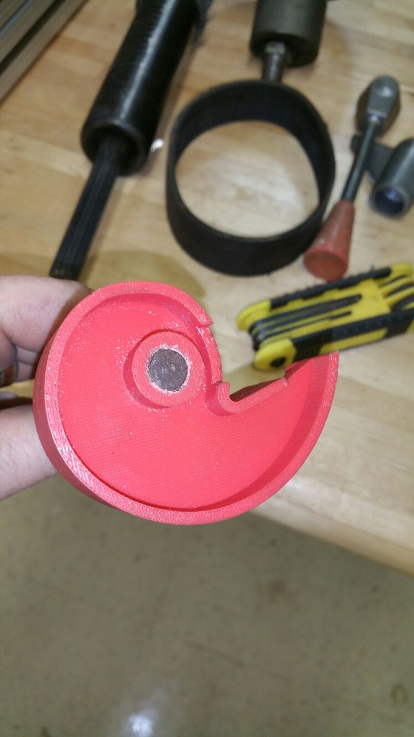

3d Printed speed control cam...
Needs to undergo testing, but it looks promising.

Wow!
What is the material? Do you know any physical properties?
What do you think of the feasibility of making a rack? How long would the segments be?

Re: Mark VII speed control
Post by richardrouse »
It's an abs thermo plastic. As soon as I get my motor bearings, I'll put the cam through its paces. I expect it to perform as well as the original plastic piece.

I got my motor bearings, I just need to get those pressed on and get everything reassembled.
Geometrically speaking this cam is pretty good. It fits the speed changer shaft and the roll pin hole is in the right spot.
It'll just be a matter of trying it out.

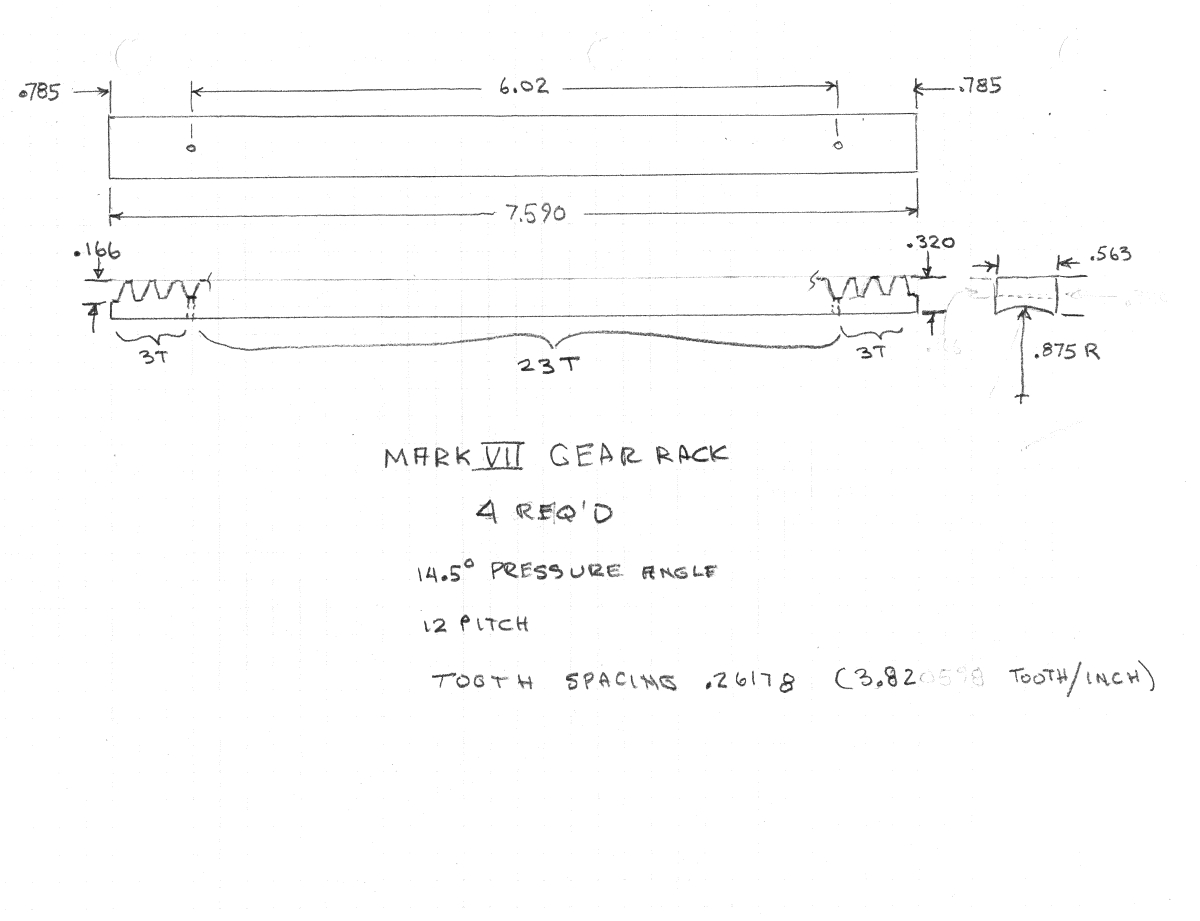

gear rack way tube 2.jpg (182.19 KiB) Viewed 3841 times
Posts: 3815
I suppose that one could buy this rack and then machine it to size. A bit pricy, though. Molded racks are more reasonable, at about 10 bucks per foot, but I couldn't find any in 12 pitch -- 16 pitch was the coarsest.
richardrouse
Posts: 220
Joined: Tue Jul 21, 2015 7:16 pm
Location: Haines City FLorida
Thanks to JPG for the drawing.
If we do this with the 3d printer, we are looking at 10 bucks per cubic inch. Using JPG's drawings I'm guestimating the cost for 4 7.5" sections to be around 60 bucks.
