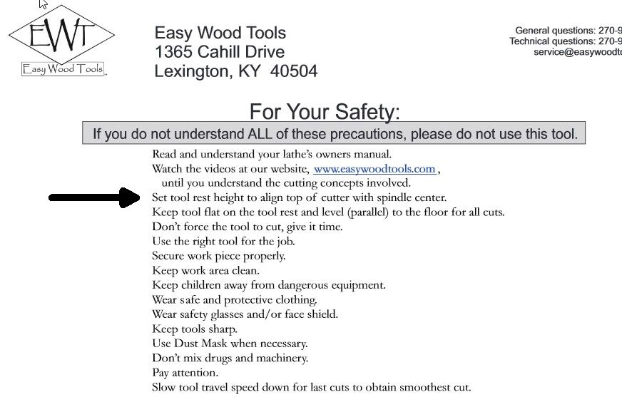

Here is a clip from the instructions that come with the ruffing tool. I highlighted, well OK I arrow-ed the part about tool position but please read the whole list.
ScreenHunter_52 Oct. 26 22.58m.jpg (69.4 KiB) Viewed 7762 times

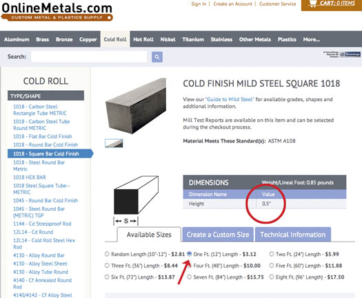

Sources for making carbide chisels (The grinder does not come with cutoff disks). Online Metals shipped pretty fast, too.
