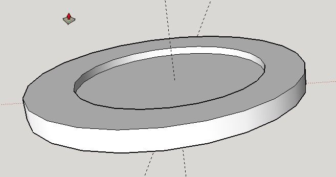

It was suggested that the wood be 1-1/4" thick and about 8" round. The dome is in the range of 5-1/2" x 10". I haven't seen the dome but I will measure it when I do for actual diameter before turning.
I've come up with 3 ideas of how I might want to do this.
The first is like the picture.
conventional dome base.jpg (18.43 KiB) Viewed 7260 times
The issue I see with this method is that the recess will be limited to how deep it can be due to the hole that needs to be in the bottom for the wires. It must be able to be done as that is what we see in the picture.
Second would be the compliment. I sort of like this as the glass of the dome is more prominent.
maybe dome base.jpg (18.64 KiB) Viewed 7260 times
The other idea that I like is this.
this might work dome base.jpg (17.22 KiB) Viewed 7260 times
So now it your turn, what ideas might you have in addition to these 3? Do you like one of these better then the others and why?
Now is the over thinking part. The glass dome will be pretty stable but the wood will move. It will move like wood does and what I would not like to see happen is for the wood movement to damage the dome as that is the expensive part of the project ($25+). Now I can make the fit pretty loose, that wouldn't provide much support for the dome but maybe that is OK? Any other ideas on this subject?
BTW the bulb will be a LED so we are talking like 8 watts of heat load.....

I think the recess as shown in the pix is preferable, but with a 'twist'.(Jehosaphat, are those staples?)
The twist being a combination of the recess and the 'groove', but the groove being very wide. The groove OD should provide for wood movement(plenty of clearance). Not so wide however so that it's diameter(ID) is larger than the recess underneath. That recess underneath need not be very large anyway.
As for the wire 'exiting', either a hole or a trough will do. A hole at the periphery to a trough inside would look nicer and be easier than a through hole.

I think JPG has it correct. You could glue two 3/4 pieces of stock together and cut it almost round on the band saw and true it up on the lathe. The bottom has to be deep enough to clear the threaded rod from the bulb base as well as the wire going through the edge.
I would not cut the groove for the dome without having the dome in hand. They will vary slightly in size. The groove can be cut on the lathe using a SHARP parting tool.
The bottom recess as JPG stated does not have to be very large in diameter but does have to be deep enough to contain the stud and the wire.

If you're worried about wood expansion version dome stability, you could build it with enough slop to allow for expansion and use some of those rubber balls that door makers use to keep panels from moving around to take up the space and keep it from moving around too easily. You'll still be able to remove the dome for bulb replacement when necessary.

The groove might be best done with a router, I have done this sort of thing before for other projects and it is easier then attempting to turn it and keep the groove clean.
Yes I have the carter circle cutting guide for my shopsmith bandsaw so I can get it pretty close then turn to the correct size. I think a very simple radius on the outside edge will work, want the lamp to be the main focus and the wood to just sort of playing a supporting role.

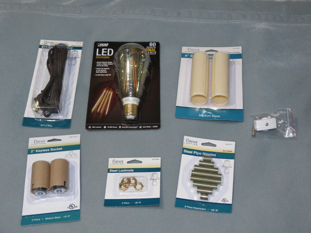

This is the hardware so far:

I make all the wood bases, for custom lamps, for our local lamp shop. I never cut or rout a groove in the base for the wire. Whether the base is round or rectangular, I always drill a 1/4" hole through the sidewall and into the bottom counterbore. I have drilled this hole in bases as big as 18" diameter. It is much neater looking than a groove.

My opinion the bottom pic the one with the groove to hold the glass is best.
If it were me I would cut the disk out on my bandsaw. Rout the groove with my router and bull nose the out side of the disk. Then rout a recess in the bottom and using a drill under the apex of the bull nose drill a hole for the cord. A nice finish and I think the whole thing would highlight the bulb the object of the whole project.

I think I'm sold on the hole in the base for the cord. I was leaning that way anyway. This should be really simple with a shopsmith, right?
The hole in the bottom for the wires I think will be done with a 2" drill bit, that looks like it will be a fine size. I think they want to put a piece of felt on the bottom which can cover the hole but be cut out if the cord needs replacing or something comes loose.
After mocking up a few ideas a wife factor will be added. I'm going to turn the base after cutting it round with the bandsaw. then the electrical bits will be added and a dome set over the bulb so it can be examined before committing to final diameter and thickness and dome mounting.

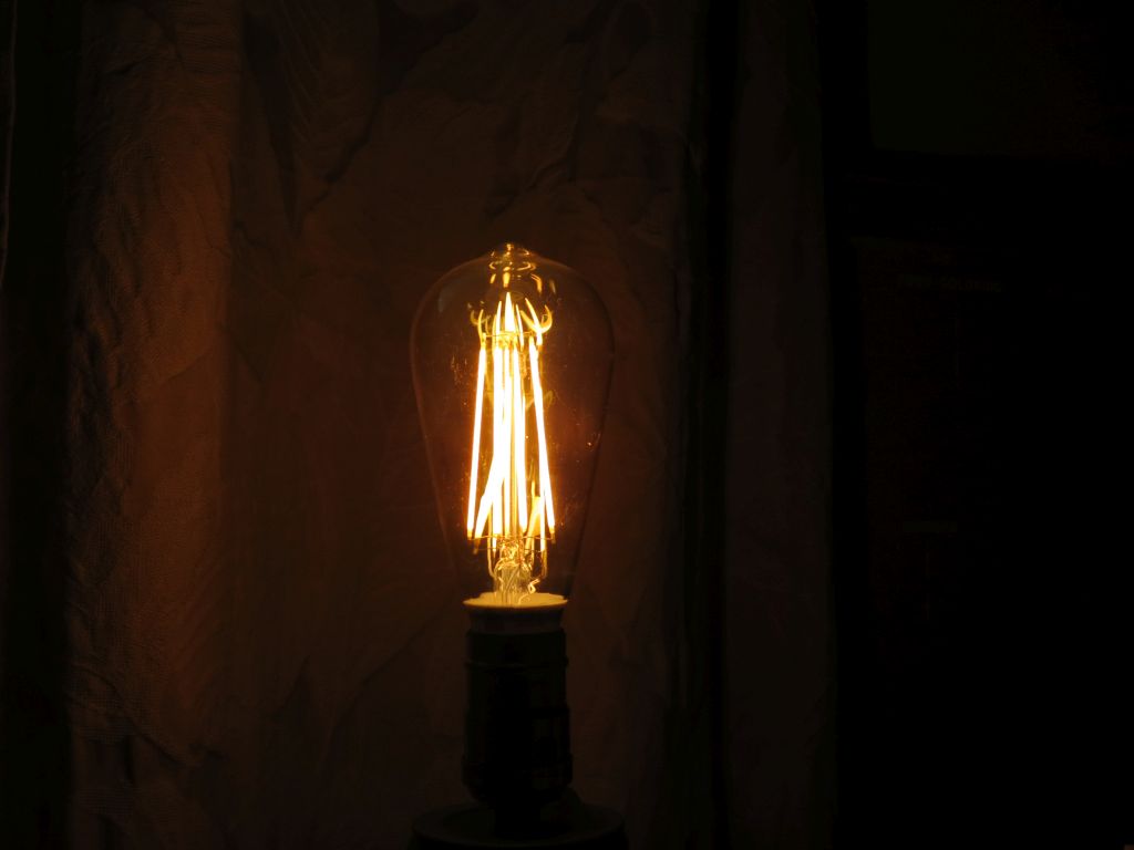

The bulb in action.
