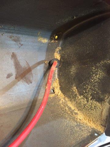

My SS was modified at some point to add the flat orange extension cord multi-plug (you can see in an earlier picture) which passed through the 3 inch access hole with the SS emblem on it. There is a round red wire that looks like it routes to the motor and then ties into the flat orange extension cord. I suspect the original would have been black. They are all 3 wire, now. I suspect I need to drill out the hole to enlarge for the new cable. I'll remove the motor tonight and see.

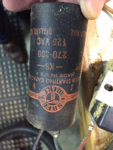

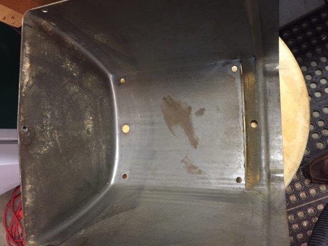

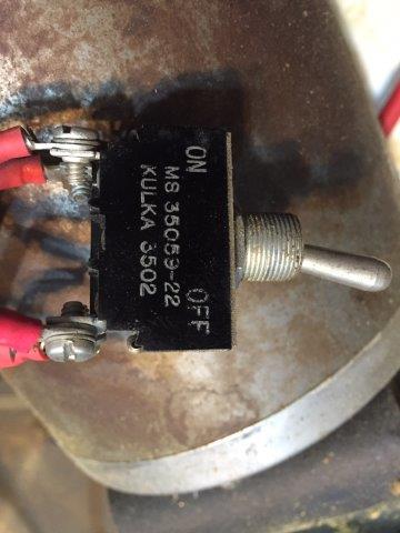

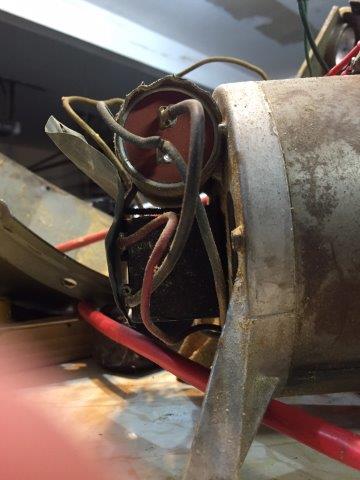

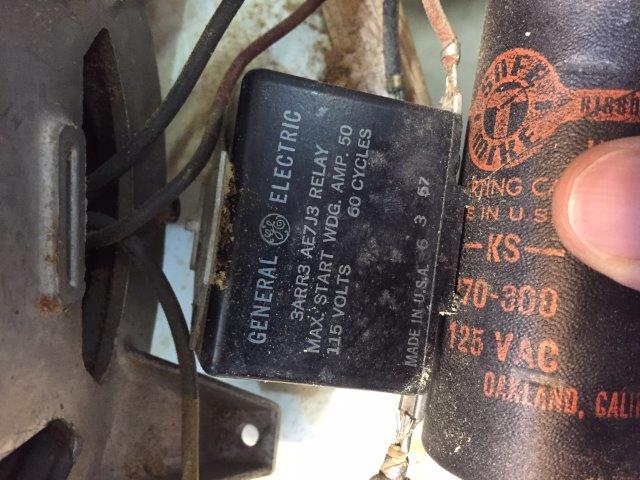

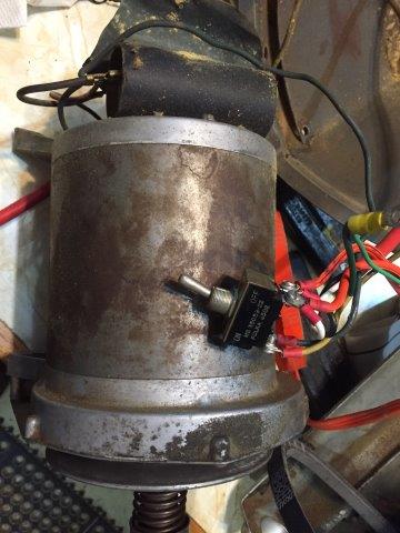

Took the motor and switch out, here are some pics. Started to clean the inside. Still need to drill out the hole in the motor pan for the cable/strain relief.
Any other thoughts and observations from the pictures?

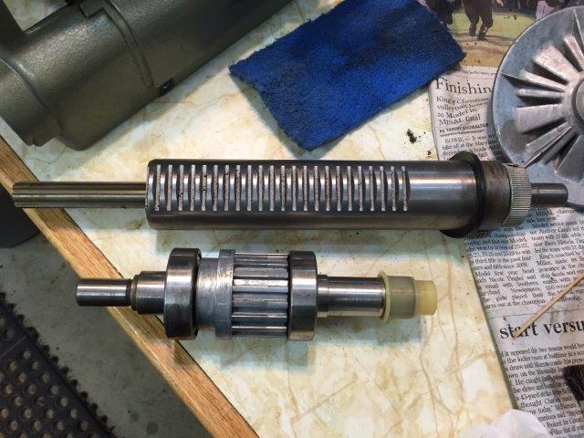

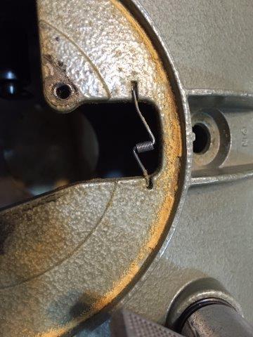

Getting ready to start putting this back together since everything has been removed and cleaned.
I have a question about the spring in the photo. Should the longer end just lay in the slot or should it have a bend that like the opposite side that fits into a hole in the slot? Hope that makes sense.
One other question is whether to wax any other rotating parts other than the quill or just leave them clean. I know the sheave shafts get oil.
thanks
Re: New Mark 5 Owner
Yes the straight end of the spring 'just lays there'.
I like to wax the bearing outer race(I think that will make later removal easier). Time will tell if that is folly!
Any thing that will rust is a candidate for waxing.
