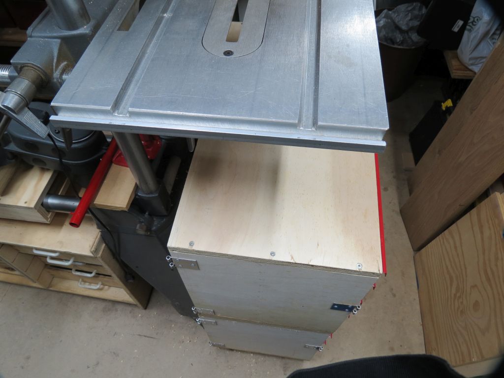

Below the table I have a stack of drawers that I built some years ago as under-shopsmith storage units. There are 4 units and I removed the wheels on two of them and stacked them 2 x 2. They are mobile for when they need to be moved We will talk about these later on as well.

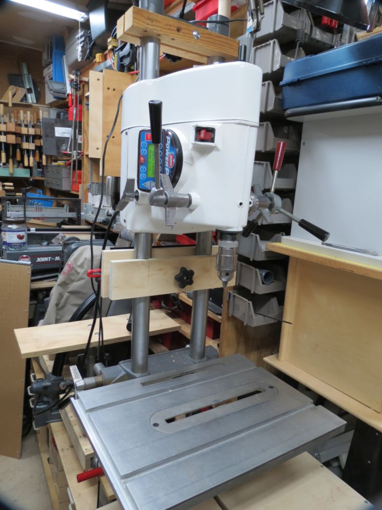

This first picture is of the shopsmith as I have it for normal operation as a drill press.
Yes the headstock is white. Yes I like it that way. Now notice that as mentioned it is with in 5 or 6 inches of the top. Notice the bracket that holds the light is at the top. The bracket holding the magnetic tray is between the headstock and table. And, yes my shop is a mess and packed to overflowing.

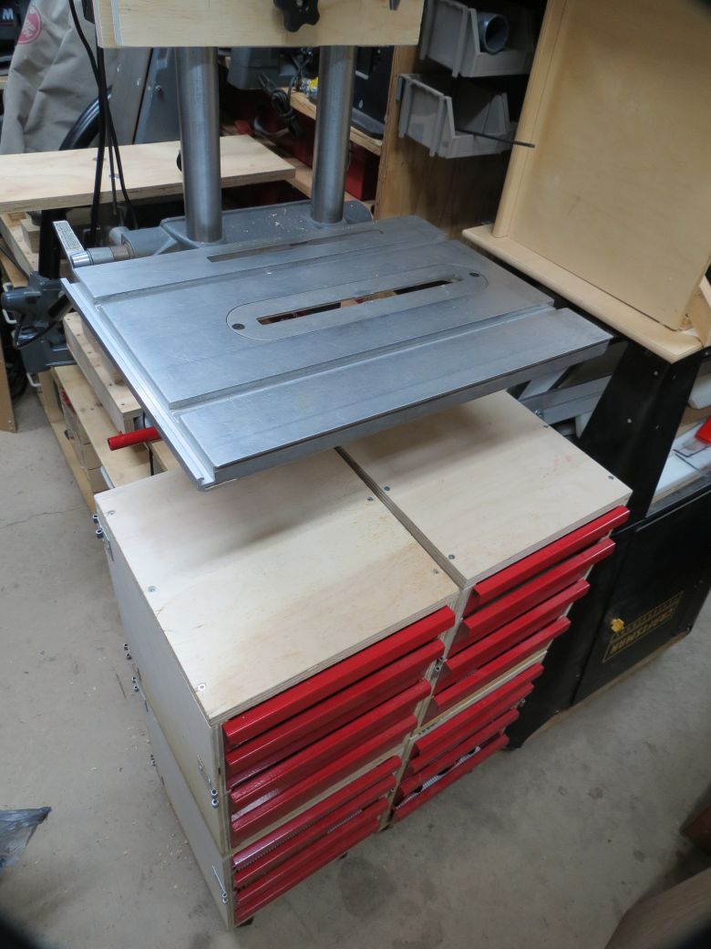

Sitting below the shopsmith table is my shelving unit(s).
If you have any questions about them or the other under shopsmith unit below this unit please check out this thread.
http://www.shopsmith.com/ss_forum/gener ... t2756.html
A few things have changed since then but it will provide some answers to some possible questions. As they are placed the width is about 24-1/2", the depth is about 13-1/2" back to outside of the handles, and it is 33" tall.
This is a different view of them.

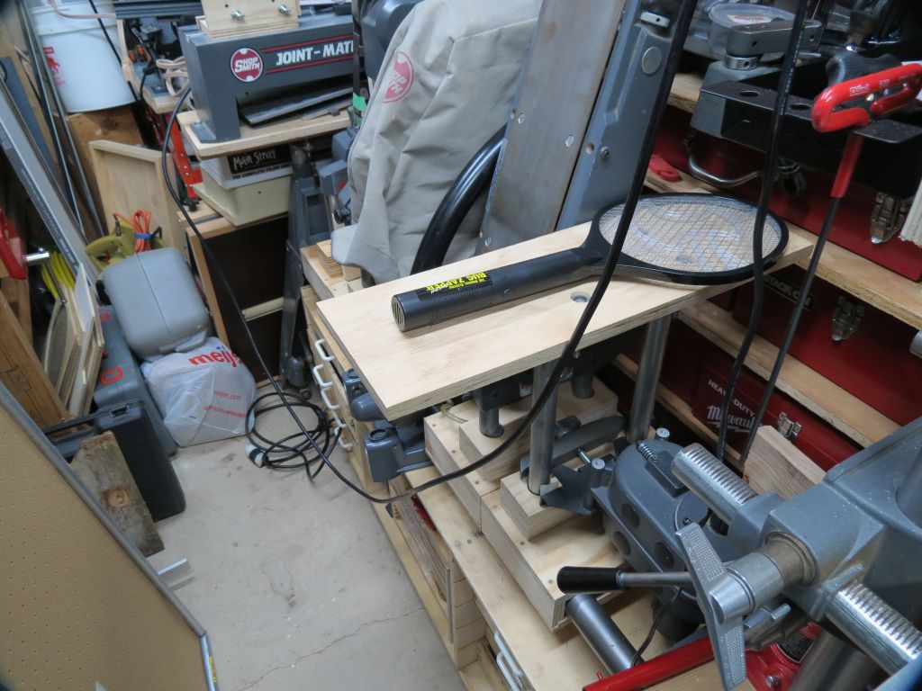

I wish I had a better picture of what is stored on the shopsmith but it is such a jumble that this will not make things very clear but here it is.
On the far end is a Joint_matic. Then with the table and arm removed is my old jig saw. Next are both strip sanders(one with a cover on it). The belt sander is next. Then there is a plywood top extension table and below that is the oscillating sander. There is even a small bit of room left unused if you can believe it. If you have questions about the home made mounts that can be found here:
http://www.shopsmith.com/ss_forum/gener ... 11176.html
In the lower storage unit I have the blade storage unit that I built here:
http://www.shopsmith.com/ss_forum/viewt ... age#p27050
The point here is that even if I had made this a shorty or a mini or hung it on the wall I would not have this much extra storage room. Keeping it full size provides all of that. And yet if I ever need the machine in another application it is will need to be uncover but it is still functional as a whole shopsmith.

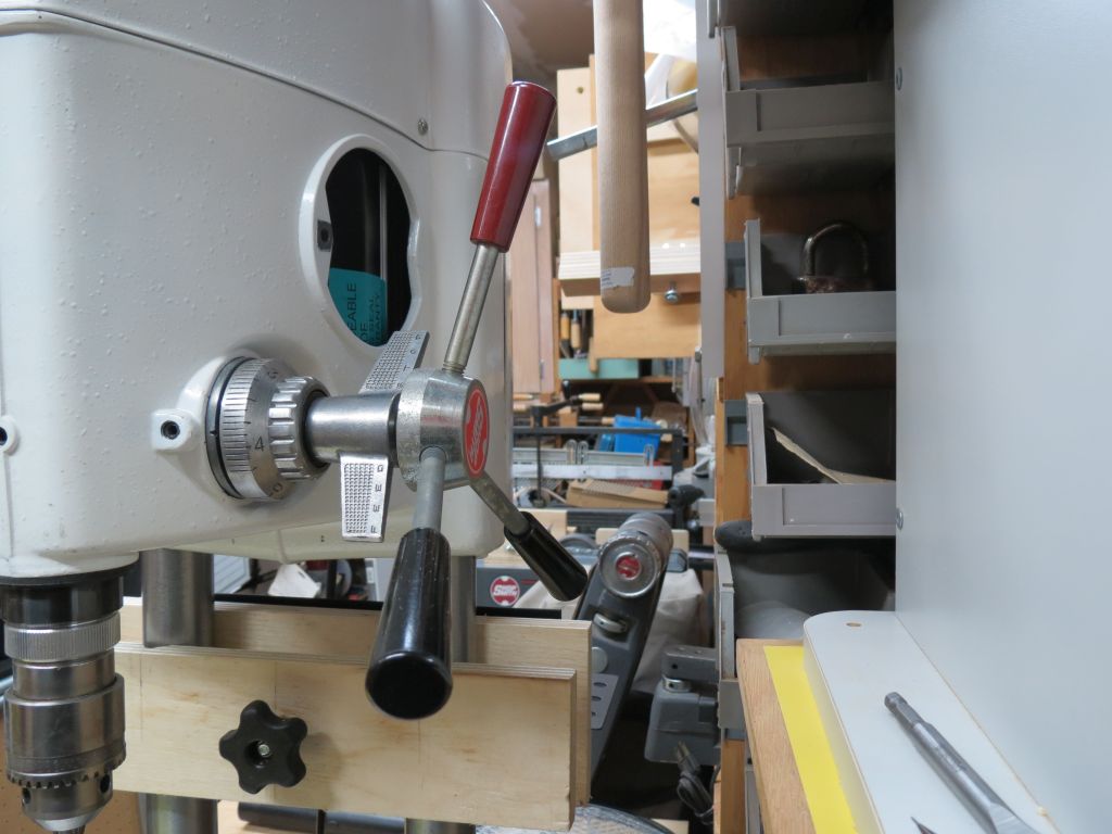

The drill press handle as shown here is going to look a little different then the factory one. Yes the red handle is the give away. I did that because I kept trying to unscrew the other ones then the one that lets you take it off. Extreme perhaps but I haven't made that mistake since the switch.

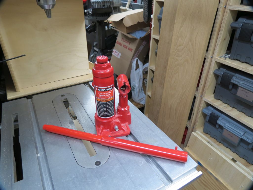

The other thing I wanted to get back to is the jack. This is a simple bottle jack that I paid like $10 for.
Way over kill lift wise but it works. This does restrict the location of the table such that with the jack in place the table to chuck distance is 13". Without the jack the table hits the cabinets below and this allows 15" of space. The cabinets can be moved so I still have the full shopsmith length possible.

P.S. I added jam nuts to my three handle quill feed handles that are not doing double duty as a set screw(i.e. the black ones on yours). I like the ER hub better(separate set screw, but larger bore).
I understand Ed. I had the same problem. What I did is wrap a piece of black electrical tape around the base of the screw handle.
