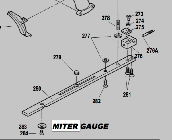

Thank you all again! I was fortunate that the screw was in the handle so i have attached it to the base. This makes a big difference as the clamp is much stronger now.
@JPG - I'm not sure what the "miter angle stop pin" is.
Also, I am missing "Taper Screw" (279). Trying to figure out what it does.

Tightening the taper screw expands the miter bar. This can help "tune" the fit of the miter bar in the miter slot and remove some of the sloppiness in the fit. If tightened further, the taper screw locks the miter bar in the slot which can be useful for certain operations.

Thanks. I'll have to get that part. I'm surprised that the handle end of the miter bar doesn't have a washer (part 283) like the front does. This would prevent the handle end from riding up. I'm sure its by design but i'm not sure why.

Underneath the 'protractor' part are three set screws. They are adjustable stops. When the 'pin' is pushed in, it will bear against the stop screws at the angle positions of 0 and +-45 degrees. When pulled out it has no effect. It only is functional when near their angle setting, and from the 'open' side direction.
Turn it upside down and you can see it better.
#276A
