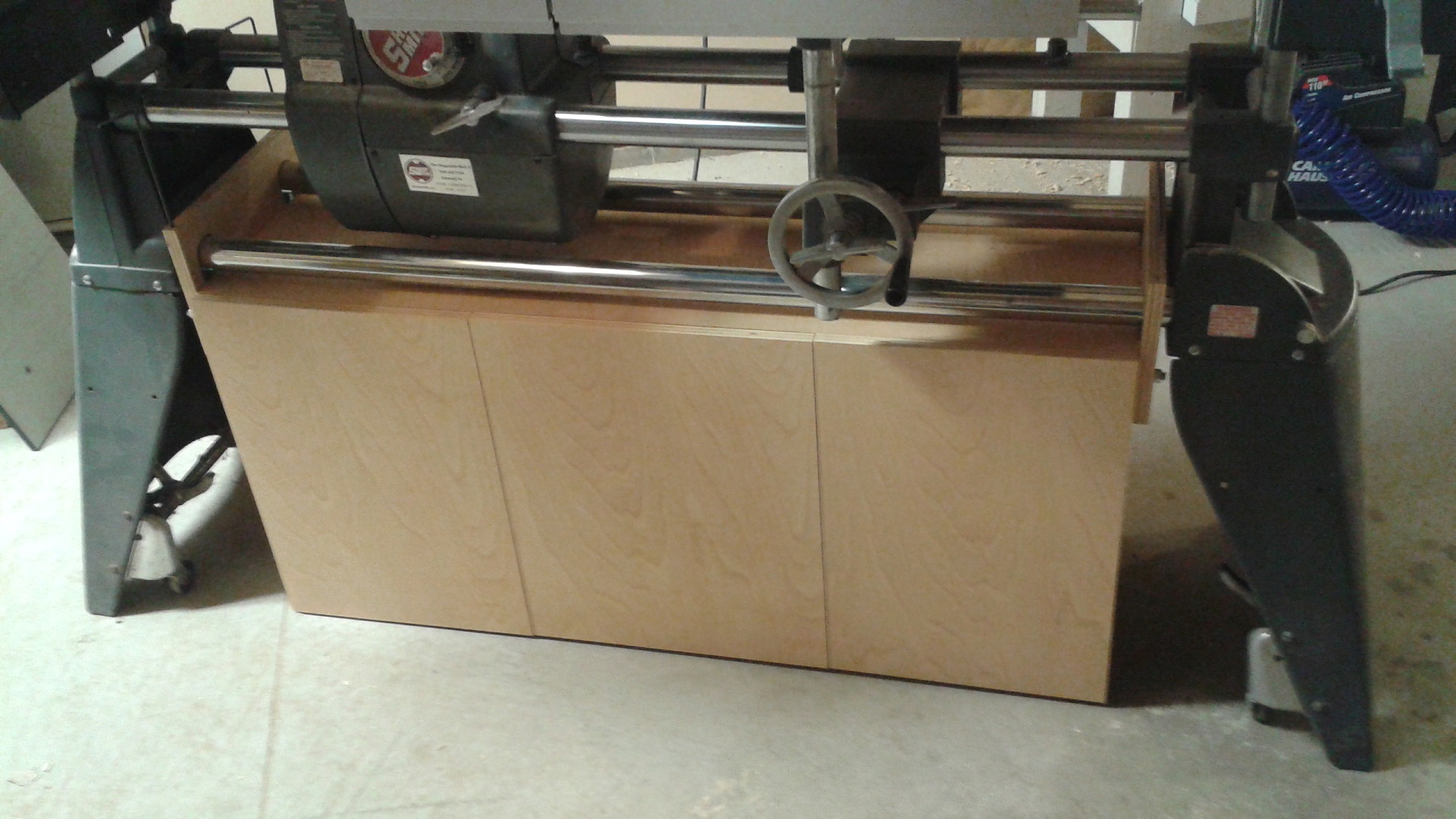

I did make last year for my Shopsmith and I love it.
http://www.shopsmith.com/ss_forum/begin ... 16336.html
Mine is attached by removeable hangers. That way I can always use it as a cabinet and the only thing that shows is 2 bolt holes on each side. That link has a PDF link to how I made it. (it also seems like the same idea you have for the "ears".
For your plan you could shorten the sides and add casters to the cabinet as well. Also, instead of a door in the middle, you could go drawers. Would be a better way to go I think.
Full Cab pict.jpg (481.53 KiB) Viewed 6230 times

If its a Mark VII, what cabinet do you want? From what I understand about the VII, it has a box below for dust collection anyways, what would you want to attach? Post a picture of the machine so we can see what your asking.
