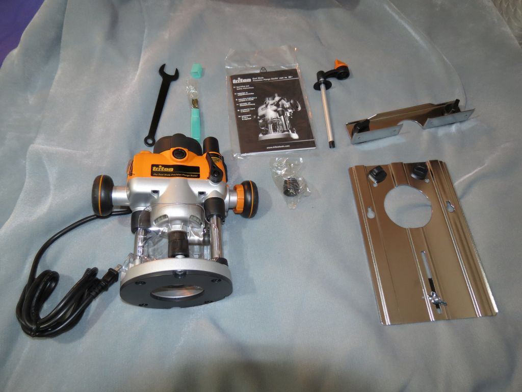

So once you have it out of the box this is what you have. Of course the router, and then both 1/2" and 1/4" collets, a 1/2" straight bit, wrench, booklet and a base with fence. The odd looking thing that is the adjuster/crank for when the router is used in a table.
I just wanted to point out a few things on the router so while this is not a review I was interested in seeing some of these things I have read about and to show you them in case you have an interest in buying one of these.

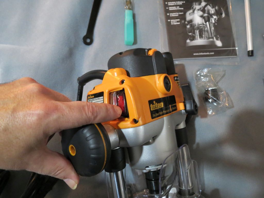

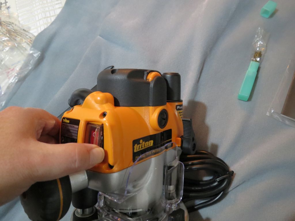

The on/off switch has a slide cover so it would be hard to have it turn on by accident. When in the on position the cover is retracted so access to the off is immediate. I've never had any of my current routers get turned on unexpectedly but I did have one that once did, I no longer have that router..... It had a cable to the trigger and when the cable came loose it let the router start.
When you have the router in the bit changing position the shaft locks and you loose access to the switch so there is no turning it on with the shaft locked.

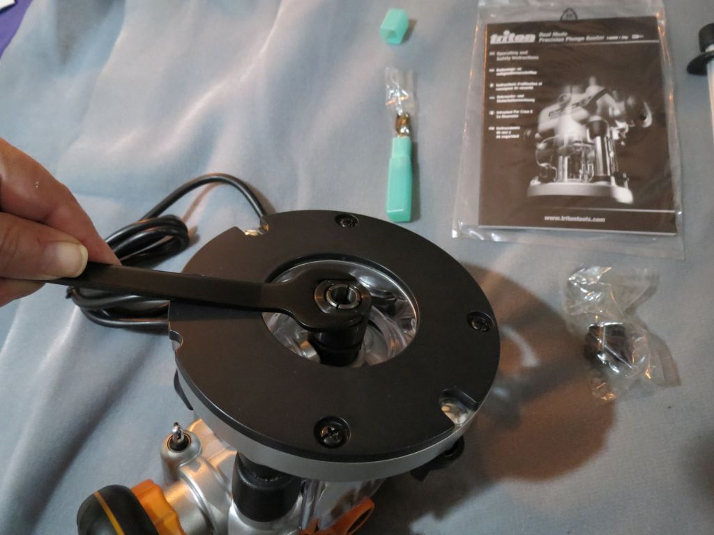

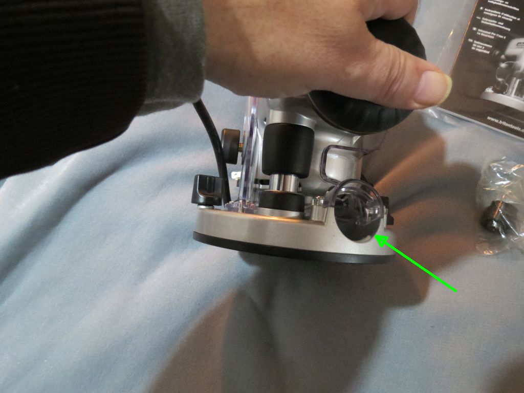

The router chuck is presented above the base when locked and the wrench has access to it so changing bits should be pretty easy.
It has a built in dust port. I hope I have a hose that will fit, that will have to wait for a warmer time in the shop.

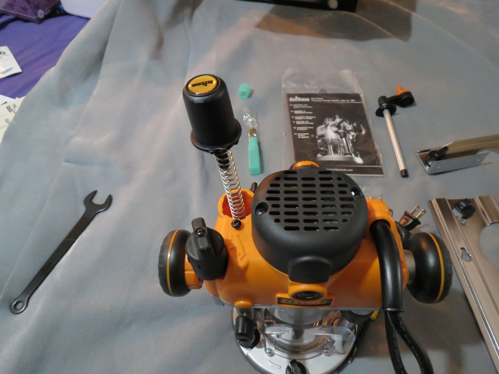

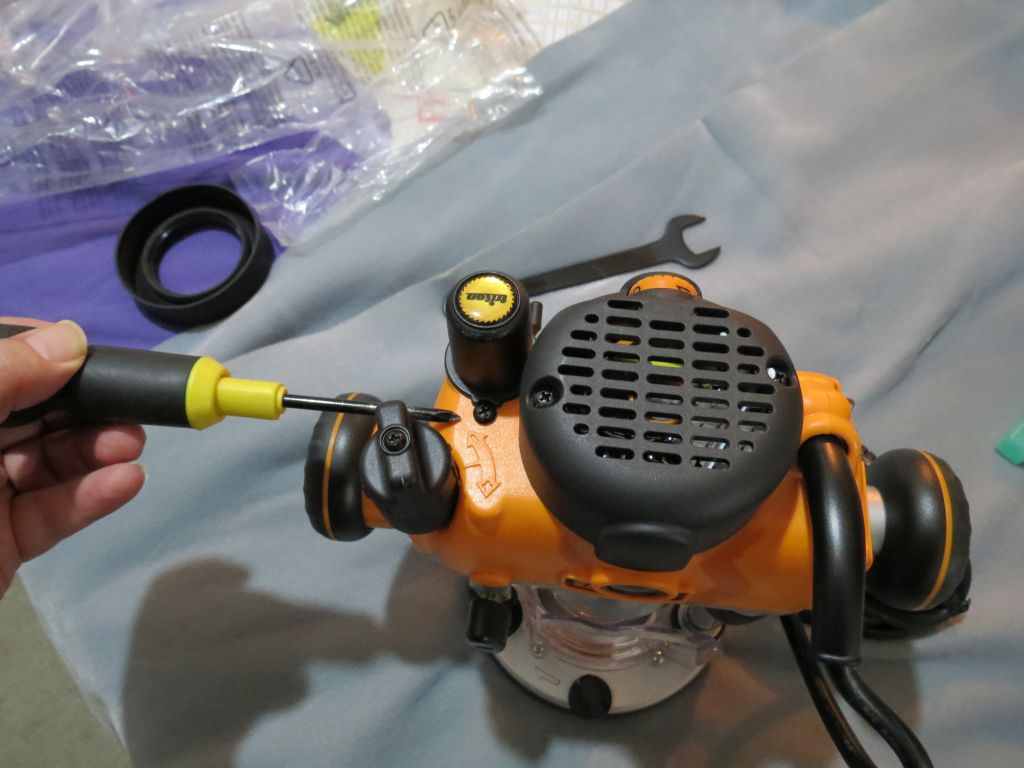

Next I wanted to see for myself how easy it is to remove the spring for under table use. It is only a matter of making sure you have the router setting without any extra pressure on the spring from being plunged. Then you loosen this one screw.
Once the screw is loose you twist the cap and here comes the spring, reminds me a bit of a jack-in-the-box but not so surprising.

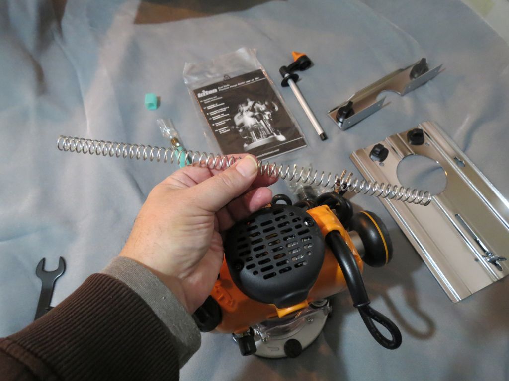

Then you simply pull the spring out and recap. To put it back in you reverse the process. A real piece of cake!
Now I get to open the manual and find out how to do what I've just done. I already know how the plunge works as well as the fine adjustment and handle twisting but I'll leave those for a review.

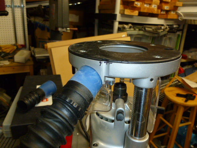

Hey Ed, is it the Dust Right universal small port hose kit from Rockler that fits your Triton router? I remember you reviewing that kit. I have the big Triton router (which looks like a carbon copy of yours) mounted underneath my stand-alone OPR table, and none of the adapters that I have will fit that dust port.

BuckeyeDennis wrote:Hey Ed, is it the Dust Right universal small port hose kit from Rockler that fits your Triton router? I remember you reviewing that kit. I have the big Triton router (which looks like a carbon copy of yours) mounted underneath my stand-alone OPR table, and none of the adapters that I have will fit that dust port.
In theory, yes
However....
Even though the OD of the blue portion of the hose is about 37.5mm and the opening on the router is 38mm, the threads on the inlet stop the blue piece at less than 1.2" in. In the picture I do have it wedged in there but would not expect it to stay without a duct tape security device. :D
I am still looking for that illusive 38mm adapter that Triton says fits. Until then I just route what I need and then vacuum up the floor and surrounding area! :rolleyes:
Another thought of mine is to use the local library's 3D printer to fabricate something but I am REALLY bad at trying to get the software to create a spiral for the threads. :o I've given up until I find a 10 year old who is smart enough to tell me what I am doing wrong!
