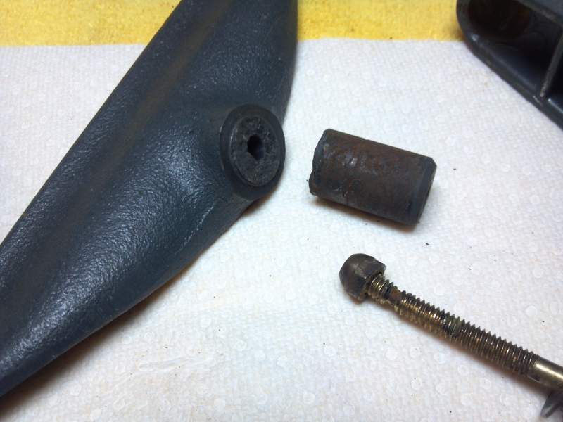

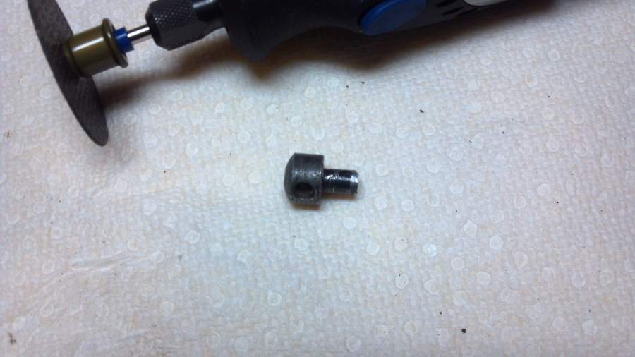

I got the button and bearing removed with no difficulty. I cut the bearing off with a dremel disc. Just waiting on all the bearings for the unit, ordered last night.
Control sheave button.jpg (38.21 KiB) Viewed 1513 times
This unit has received some abuse!

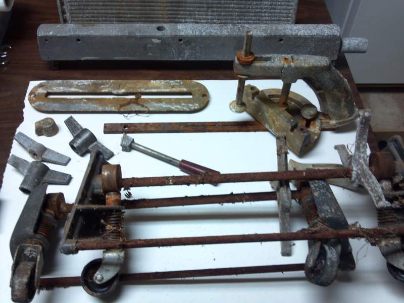

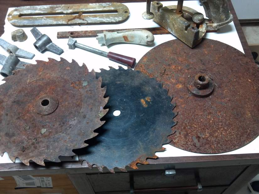

Here is the sad state the accessories are in.
Accessories 1.jpg (53.96 KiB) Viewed 1499 times
Accessories 2.jpg (65.96 KiB) Viewed 1499 times
It's too bad people that have lost interest or uninterested inheritances could protect this stuff with little effort.
If I were going to store something away outside for a long time, I would at least coat everything with used motor oil and cover it with a tarp.
I think it was common practice for farmers to coat their plow shares w/used motor oil thru the non-plowing season.
Re: Local SS stray needing care
As it is, you have a little bit of cleanup work to do. Other than that, you'll be making sawdust in no time.
