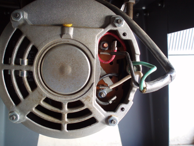

The motor terminal block (which you indicate has five terminals and three wires) is the tricky part. Pictures would help. Wire color might help. An answer that there are four wires coming from the motor (1 white, two black and one red) would clear up a lot. Let us know.

The attached picture IS NOT of the motor you have but a picture of this sort from your motor would help. This is a Shopsmith motor of a later vintage and this motor is reversible. For those reasons it should not be used as a guide to connecting your motor wires.

Are any of the terminals on the motor labeled. The power cord would connect to something like L1 and L2 or L1 and L4 if they are labeled?
If you have terminals labeled A and B or Tab A and Tab B, those are the run windings and would connect to two of the wires coming out of the motor.
PS added at 2:00am
- Power Station Wired Normal.JPG (154.66 KiB) Viewed 21614 times
