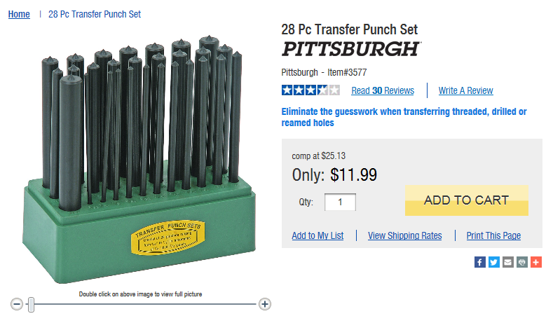

stopped at Harbor Freight to today to get a few things.
Got a transfer punch set 3/32" to 1/2" (28 piece set). sure will make it easier transferring holes to another piece/s. Better than trying to use a pencil or a center punch in the hole to mark in on the other piece and always being off just a little.

Have the same set. 12 bucks well spent! Transferring holes was never easier. Also use them to fix oopses when making pens.

Never having used a transfer punch, I am curious as to the possible uses.
I understand that a punch shaft can be inserted through a hole of a certain size to mark the exact spot to drill another hole, but where and why is this tool used.
Please explain to this old guy!

Think pattern and several 'blanks'.charlese wrote:Never having used a transfer punch, I am curious as to the possible uses.
The pattern is positioned over a blank, the punch is inserted into the hole in the pattern, and struck. The dimple in the center of the transfer punch makes a ding in the blank. The pattern hole is sized to the punch. The final hole may be an entirely different size from the pattern hole.
It allows locating the center of a hole with a pattern or a mating part.
