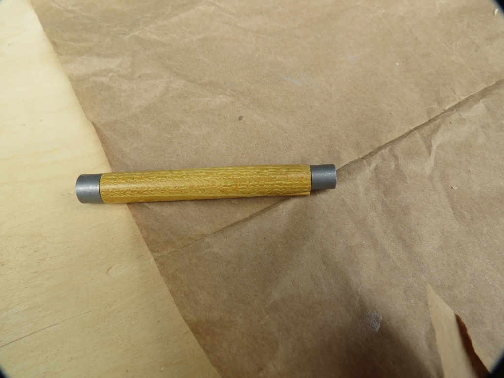

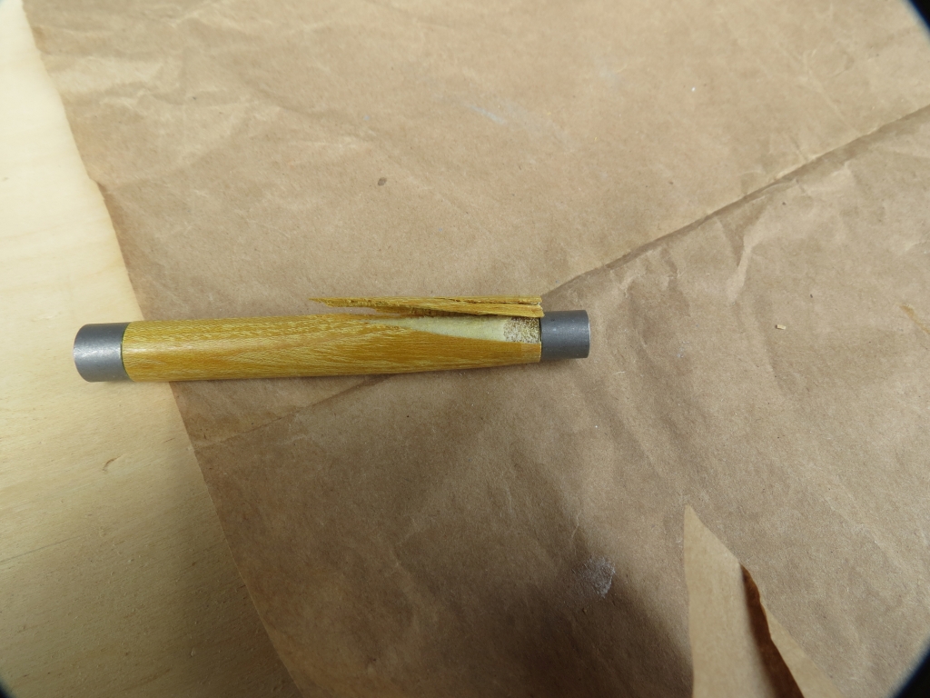

You know how on some days things go well and on others not so well?
In this thread:
http://www.shopsmith.com/ss_forum/viewt ... 9&p=209443&
I mentioned that my wife had picked out osage orange for this project, a wood I had not previous worked with. It has been setting ready to turn for a while now waiting for a bit warmer temperatures to work in.
The drilling went pretty easy. It didn't seem all that hard but then it was a sharp letter O drill bit so maybe that is why. The initial turning went fine, again it didn't feel that hard.
I got it rounded and started the sizing, still all is well and no catches or problems at all. I'm down to taking a really really light cut, the final pass before the sanding process. It has a really nice smooth feel and I'm thinking this is going really well and this is going to finish really nice.
Well you know that from the start that it didn't go so well. I'm now at the far end on my last pass and just the lightest of cuts and bang! Well so much for that blank. The wood has a "stringiness" to it and right at the bushing I managed to catch it.......
So a new blank has been drilled and a new tube has been installed and tomorrow we will start over again. It did require me to take a trip to the woodcraft store, a little bag of parts in hand I also stopped at the harbor freight for a few things. Don't mind tool shopping so it was a good enough day even with the problem.
As you can see it is going to look nice once it is finished.
So the world turns.

I feel your pain. I've had it happen a few times. Black Palm can be a real pain too, especially slim-lines pens. With the Black Palm I stop at least 1/16" proud of the bushings and then sand.
Your seam ripper is gonna look nice. I like Osage orange.
