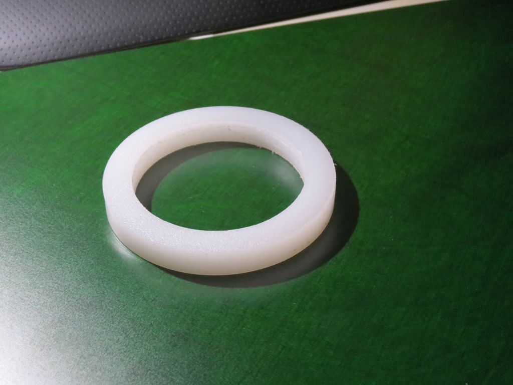

I got my column size stop collar and that thing is huge! Well it has to be I guess as it real uses would require it.
Now this improvement I think needs another minor improvement. I was looking for some inside projects for today and one of them was to make an equally large washer to put between the arm and the stop collar.
As I have shown in the past the cutting boards from Sam's Club have a lot of uses. Today's use was to make a large washer.
The inside hole should fit the column and the outside is about 4" and it is as thick as the cutting board. I have yet to put it on but I'm off on other projects now and wanted to post the idea and let those who might be interested think some more about it. After it is installed and I get to try it out I'll let you know how I feel about it.

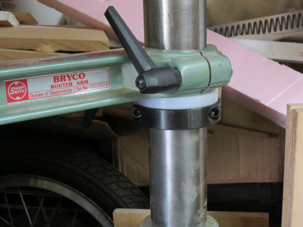

Finally got around to adding the stop collar and the plastic insert to my OPR today. Works slick!

Is that a motorcycle wheel behind your OPR?reible wrote:Finally got around to adding the stop collar and the plastic insert to my OPR today. Works slick!
