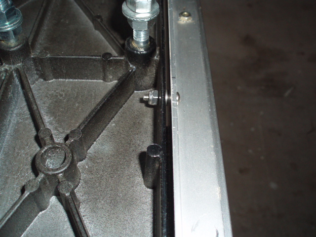

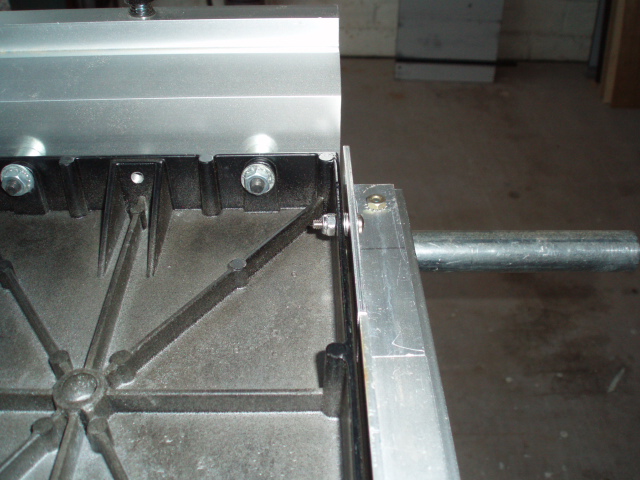

Originally, I had a lot of concern about attaching to the extension table. I believed I could do serious damage to the table. I no longer feel that the tables are all that vulnerable.
I have drilled the table edge to accept bolts that are being used to secure the t-track to the table. To deal with the uneven edge to the table, I have inserted some flat washers to fill in the space (as required). This won't be necessary on some tables. I have one (maybe two) table(s) that is(are) as straight as could possibly be.
These are cast aluminum tables. They are not all identical. I think it has to do with how old (damaged) the mold was when the table was cast. Some come out of brand new molds while others come from molds that are due to be replaced.
Whatever your case, just don't torgue down on a bolt that has space between the table and rail (at the location of the bolt). Use spacers to fill the gap.
A couple photos to follow.
Extension Table with a T-Track

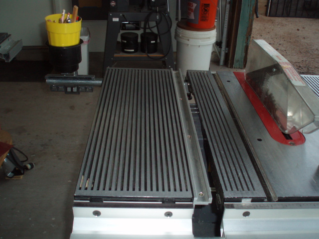

[ATTACH]2104[/ATTACH]
The miter gauge in a t-track attached to a floating/extension table. This is not really required here because of the near proximity of a t-track in the main table.
[ATTACH]2105[/ATTACH]
The underside of an extension table with the t-track attached. Note the washer between the t-track and the table.
[ATTACH]2106[/ATTACH]
The same t-track installation but note that there are two washers under the t-track. The third bolt required NO washer but is not pictured here.

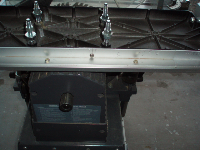

[ATTACH]2107[/ATTACH]
The aluminum angle attached to the side of an extension table.

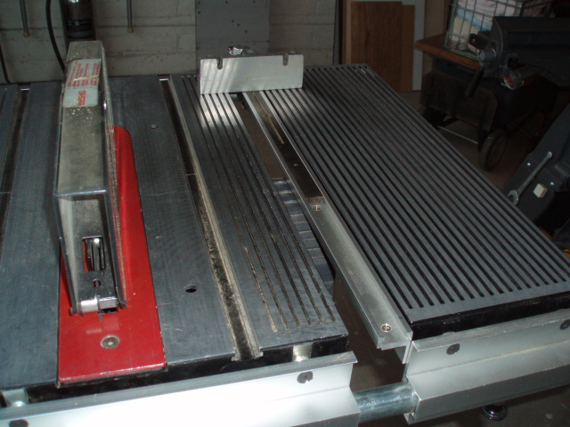

[ATTACH]2108[/ATTACH]
Another view of the t-track attached to an axtension table.
