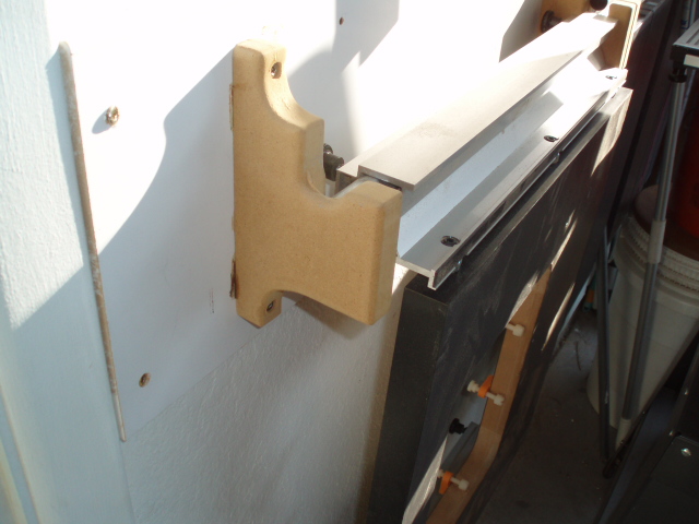

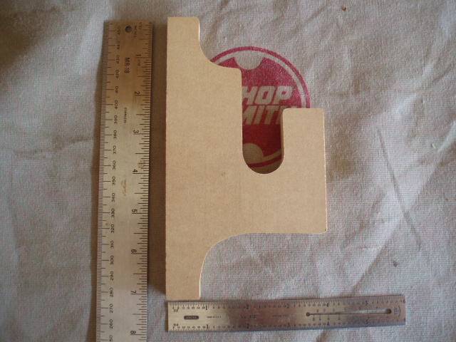

wdelliott wrote:Dusty,
In looking at the photo of your garage wall, I see your storage method of hanging your SS tables. Could you explain your system and how it works? Thanks.
Bill E.
Ravenna, Texas
First of all, give some serious thought to what you want to hang. I did mine and then found that I wanted to hang items that I had not planned for. I need to redo mine]2118[/ATTACH]
[ATTACH]2119[/ATTACH]
[ATTACH]2120[/ATTACH]

We probably need to start another thread or go to the one titled "Storing support legs and connector tubes"

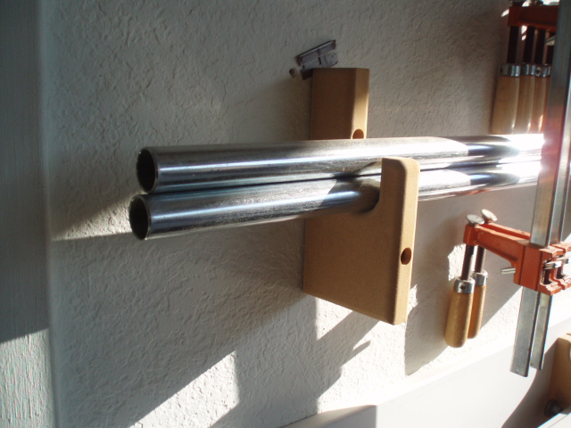

Just this week I designed and built a protype of my wall mounted hanging table system.
I have 6 connector tubes (one a 5 ft'er) 2 main tables, and 2 floating tables I want to be able to store in as compact a space as possible.
I built brackets similar to Dusty's but I have four slots cut in mine. On the top I store the adjustable leg/connector tube assemblies, In the next I store my two connector tubes and in the next a spare connector tube which supports my floating tables and in the last my spare main table (converted to a router table)
My problem if I want to use only one aux table I have to set the other on the floor or something since due to balance problems.
I'm rethinking my approach. I'm considering using pipe or conduit to make my hanging supports and do it in a way that any one component tube, table (main or floating) can be taken down and used without effecting anything else on the rack.
On the very top of my brackets is shelf that now houses my jointer at waist height so it is easy to move from the shelf to the SS in basically fluid motions.
Just to the right of my bracket is another shelf where I store my Bandsaw, Sliding crosscut table, my bandsaw circle cutting jig, and a few mitre guage extensions.
