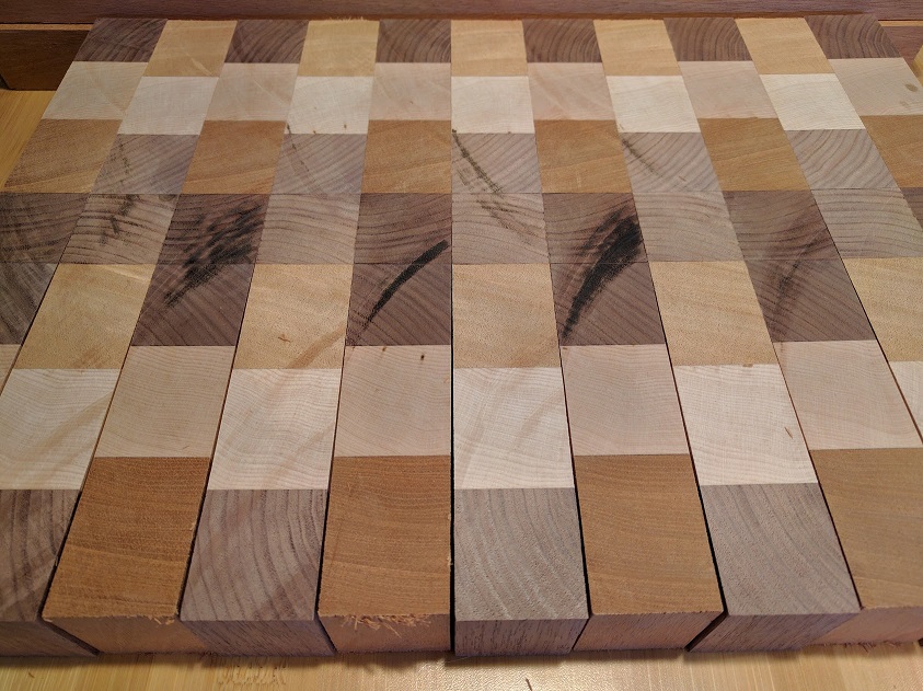

I then cut those into the pieces that are flipped for end grain, and found out (after cutting them all), that the pieces were slightly fatter in the middle than on the edges. So, shaped sort of like this: (). Not much (I didn't measure), but when multiplied by the number of pieces glueing up for the final cutting board, those differences were too much for me to overcome with clamping pressure. (I attached a picture, where I have the pieces tight at the top of the picture to highlight the gaps at the bottom of the pieces)

Trying to add a picture showing uneven planing once I had made the crosscuts and turned the pieces for endgrain. It was too big so I had to reduce the size.

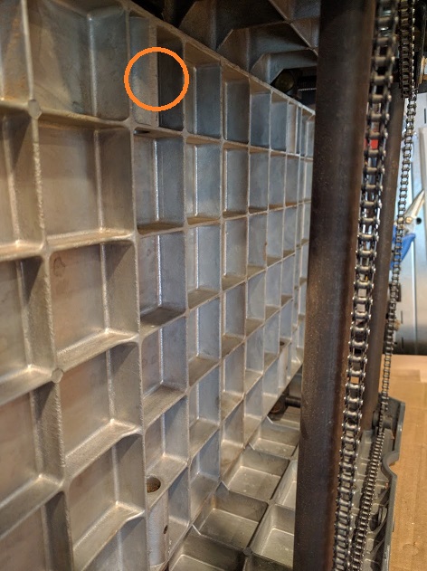

Here's a picture from the underside, the orange circle highlighting no setscrew on the underside.
underside_full_view
underside_full_view
Here's a closeup of what looks like could be a setscrew, but seems to be more of a rivet. I have no alan wrenches that would turn it, and looking through a magnifier it looks like a circle.
rivet closeup
rivet closeup

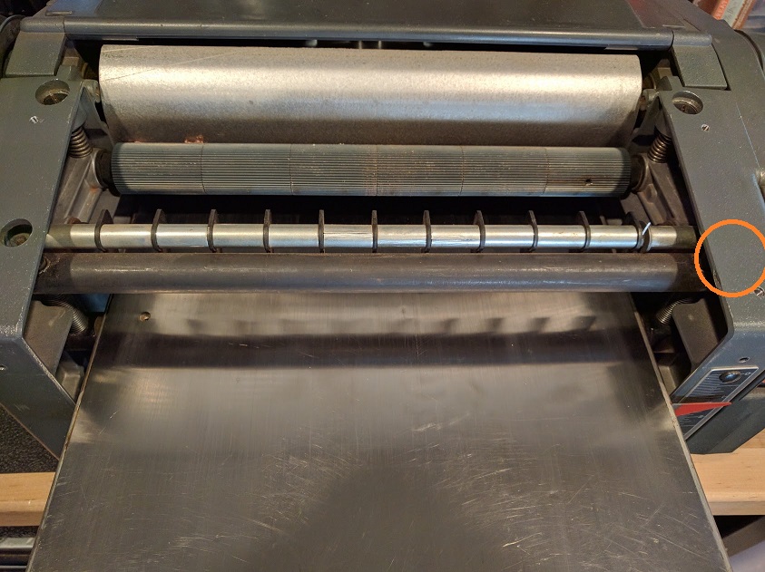

And from the top, I don't have holes to individually turn the table elevation posts:
top view
top view
So, I am sort of guessing now about how I would go about getting them more in sync. My thought is, forget the set screws since I can't see any, loosen the chain tension and remove it from the sprockets, then raise the table posts by somehow turning them by hand from the bottom or inserting a small wrench in between the top of the post and the case.

Those 'round things' are tension pins. They press in. They retain the table connectors on one side.(the BLACK THINGS WITH A BRASS INSERT)
The chain/posts are synchronized by removing the chain and adjusting the 4 posts for equal spacing the the cross bar. Care must be exercised to prevent the sprockets from rotating as the chain is reinstalled and the tension sprocket tightened.
As Bill mentioned, 0.004 is the resolution/tooth.
Check for table concavity across the table. If none, the blades are suspect.
Check cutter height(use the knife setting gauge) at both the ends AND the middle.
