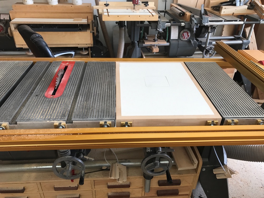

Great idea and work Paul. Is alignment to the saw blade maintained when re-installing the rails to the main table? What kind of repeatable tolerance can be expected?

I have broken it down twice just to see how accurate the reassembly would be and it was right on the money upon reassembly. As long as the brackets remain solid and in place there should not be an issue.

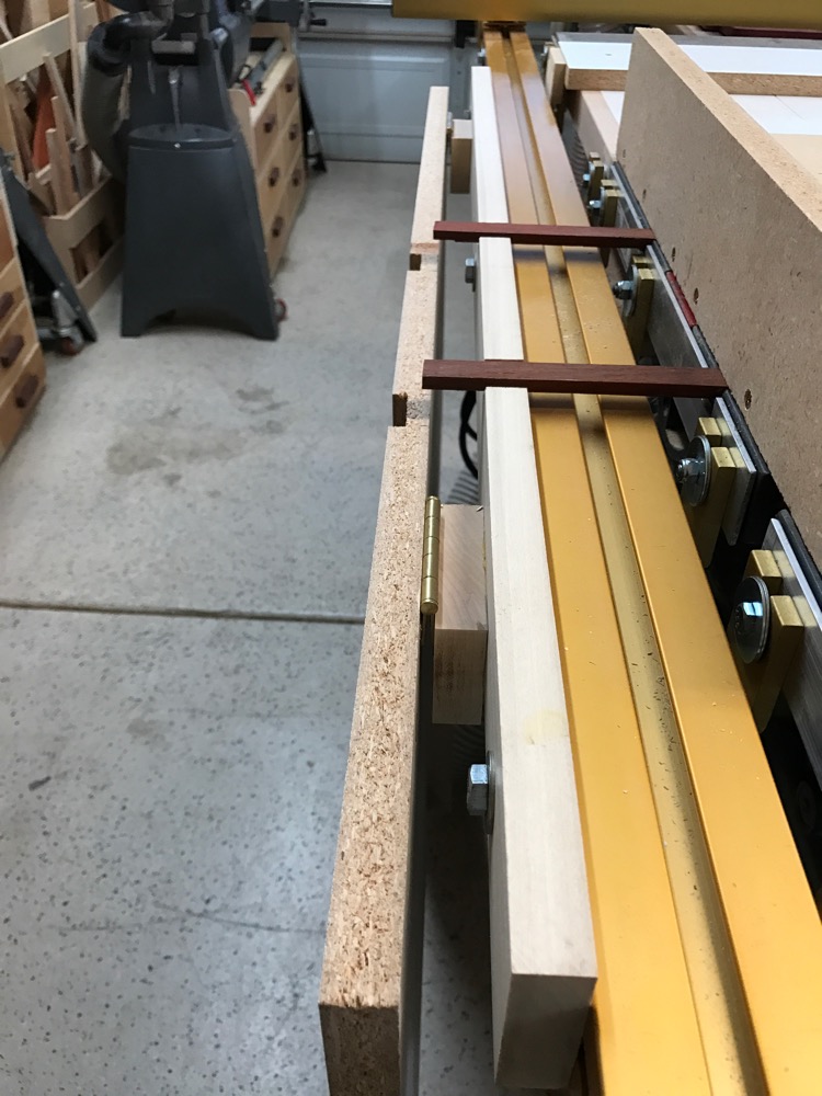

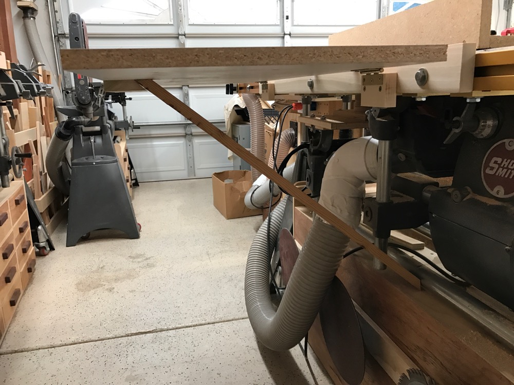

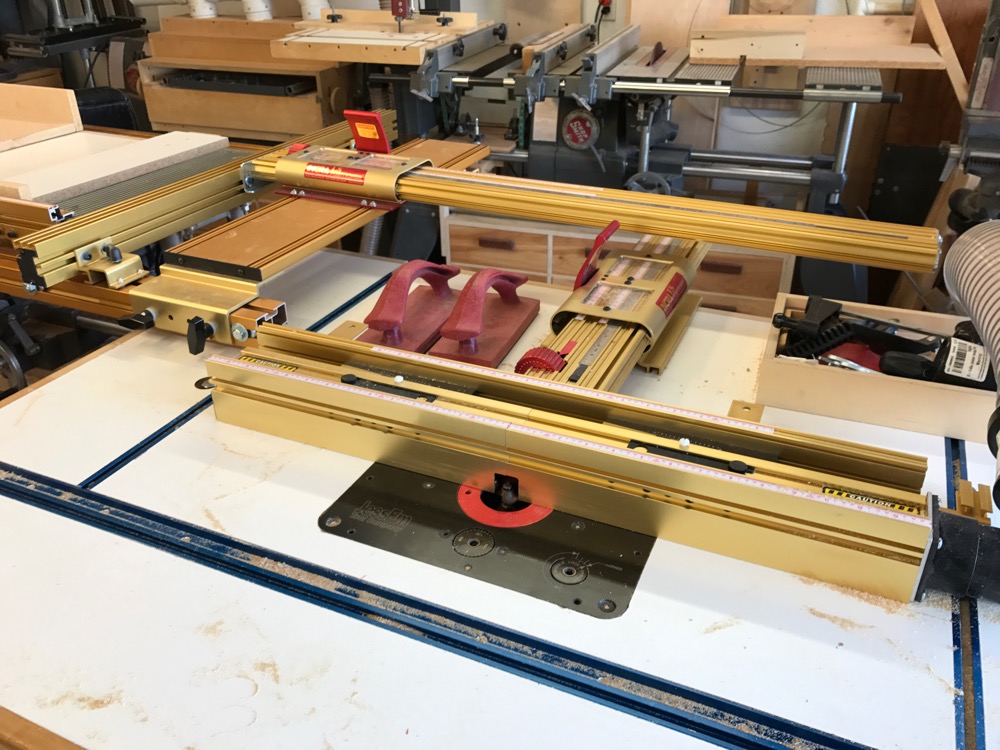

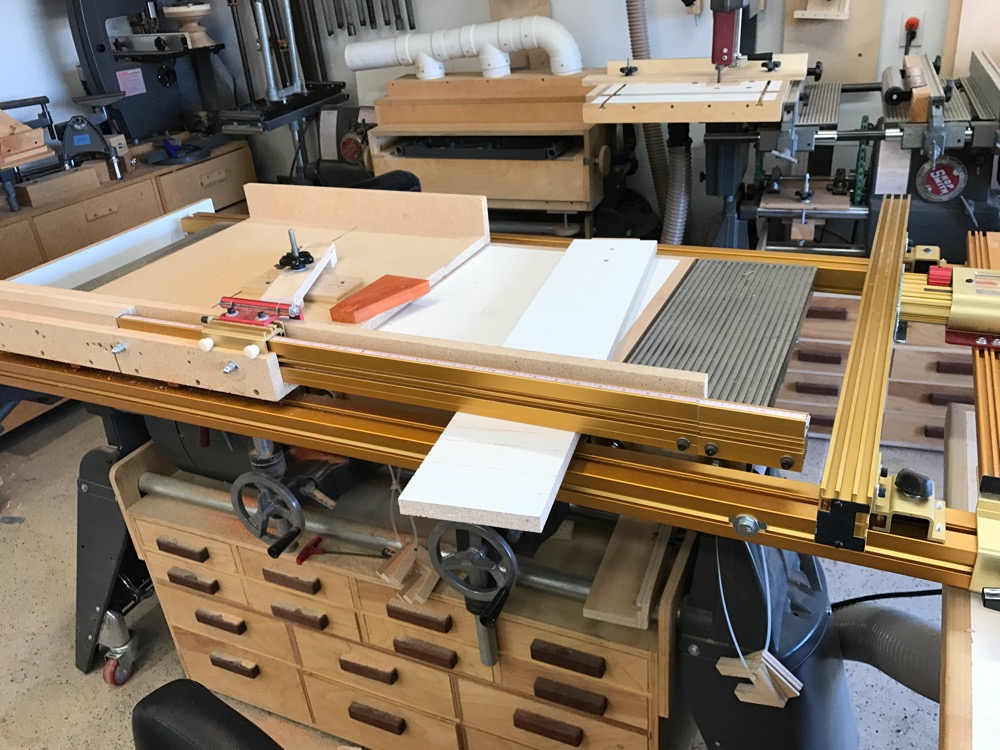

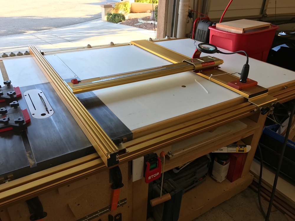

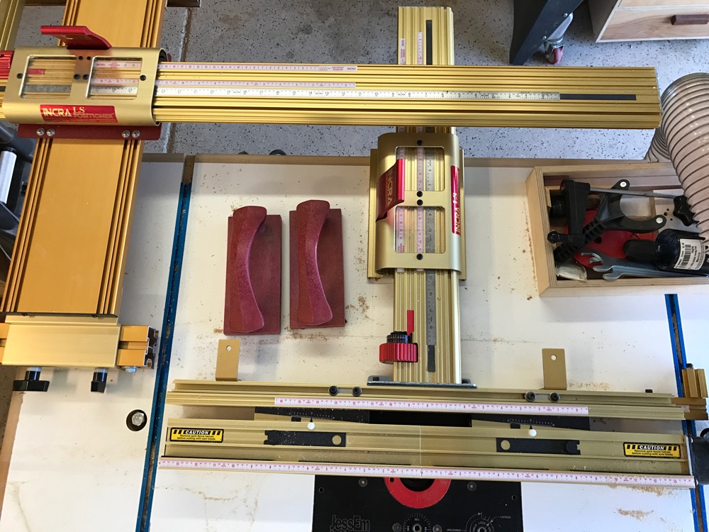

I finished the installation of all three Incra fences and the PP upgrade. All came out pretty well. The spacial arranging of everything became a challenge. The one and only drawback I see so far is that the Incra fences require a lot more room that the SS fence systems. I made it work but it was interesting to say the least. Fortunately the SS is a couple of inches higher than the saw and router table which allowed the SS to pass over the router table setup. It all works with full function but it was tight. As far as the fences themselves they live up to the Incra reputation. Very tight tolerances and repeatability. I haven't really had a chance to use any of them extensively and that includes the PP but at this point pleased.

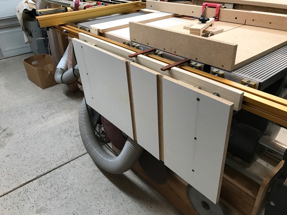

I added a runoff table to the SS with the Incra fence today which completes the installations which is a good thing since the boss came into the shop today and announced " times up ", which means quit messing with the machinery and start making something. They delivered 100 bd ft of mahogany yesterday so now she is raring to get going. Interesting she also got 1 bd ft of ebony for accent on a table that is in the pipeline. That stuff is crazy expensive. I have had a stash I have had for 25 years and finally chipped it away to nothing. Very weird how certain woods have become so valuable. Suddenly $25.00 a bd ft is the norm for tropical hardwoods. Ebony is now off the scale. Unfortunately it is still the only really black wood out there. Should have bought a warehouse full back in the 79's or 80's.
