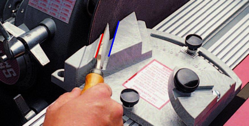

In the video he says to set the gauge at 13. Then with the point of the skew up grind on the front of the gauge (blue line on pic). Then flip the skew with point down grind on the rear of the gauge. (red line on pic). He says you will have multiple grind makes but you have to keep grinding till you only have one. In this pic they are using a chisel instead of a skew. Hope this helps.
- sharp_guide_chisel.jpg (61.89 KiB) Viewed 20955 times
