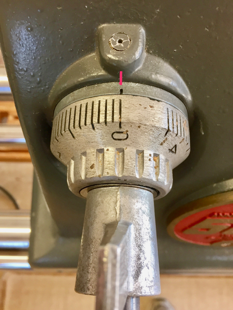

I greatly appreciate everyone's input. Here is what I have done so far:
I removed the the entire quill lock assembly and cleaned it. I then put it back with the flat part at the bottom and the index at the top.
FullSizeRender 4.jpg (422.02 KiB) Viewed 4605 times

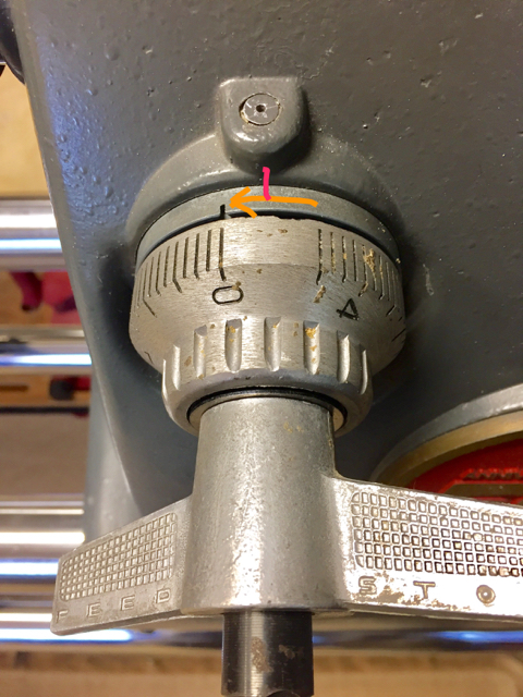

Since I've put it back in the correct position, it seems to work properly. However, I if I extend the quill with "a little" too much force, the assembly turns out of position to the left again. This is probably what has been happening, I just didn't notice it.
FullSizeRender 3.jpg (408.9 KiB) Viewed 4605 times

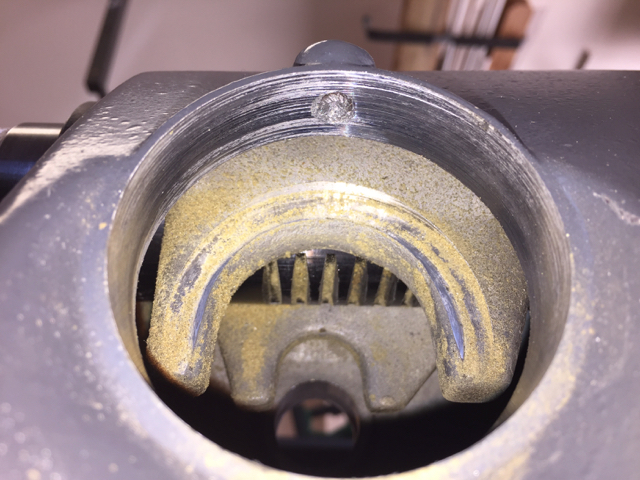

We've all been talking about the set screw and I think that it might be part of the problem. When I had the assembly removed, I took a photo looking up into the opening and the focused on the underside of the set screw. To me, it looks like the bottom of the screw has been worm down and may not be holding the assembly in place.
IMG_1273 2.jpg (368.86 KiB) Viewed 4605 times

The set screw is not 'worn', but needs to be tightened(putty removal necessary).
