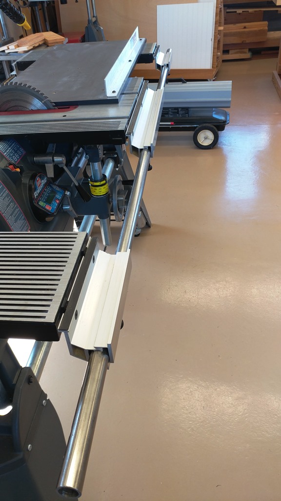

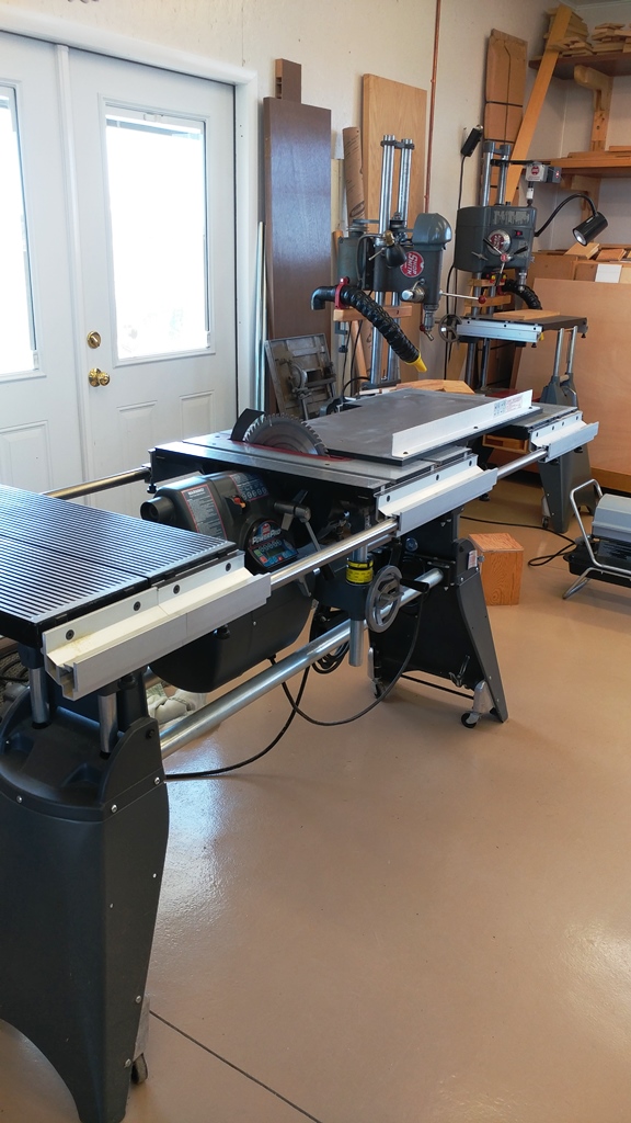

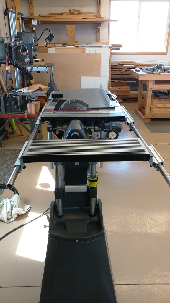

The tubes I ordered from Metals Depot came yesterday. My 5' SS tubes are not straight. They are not real bad but still not straight. The tubes from Metals Depot are 6' long 304 stainless steel with a 0.120" wall. The roll test says they are straight and with that wall thickness I expect them to stay that way. As one would expect they are very rigid.
Also the 6' length allows you to add an outboard floating table on each end. No need for telescoping legs. The tubes are plenty rigid and of course 6' is not long enough for legs.

John, they look great. About the same price as the solid precision ground ones that I got. I still like the heft and precision of mine but have to put up with the extra weight. I am able to get the same fence to miter slot precision when mounted on one of the floating tables that I get on the main table, about .001 to .002". Never was able to do that before even with the short shopsmith tubes.
Re: 510/520 table connector tube length
Looks good John! Set up that way, changing height looks like it would become easier/less complicated. Do you find instability (racking) becomes more of an issue without the fixed table included in the set-up, or does it seem fairly stable as is?

Oops, I just noticed you are using the fixed tables tooecom1 wrote:Looks good John! Set up that way, changing height looks like it would become easier/less complicated. Do you find instability (racking) becomes more of an issue without the fixed table included in the set-up, or does it seem fairly stable as is?

Did you say that the depth of cut could easily be changed without removing the extension tubes?
If you did, I have something bad wrong with my extension table tubes. My extension tables do not adjust easily even when unlocked.

Those look great, jsburger! I think I'm going to order a set.
