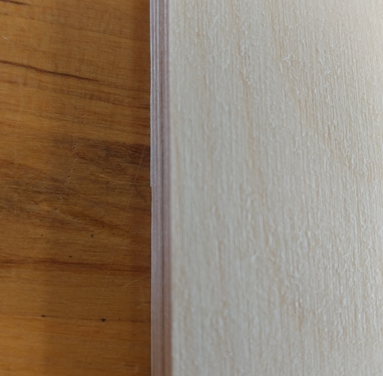

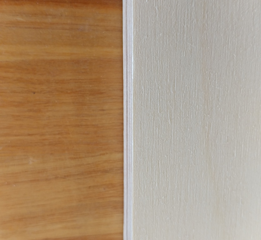

I cut some 1/2" Baltic Birch ply today. The first picture shows the top side and the second picture shows the bottom side. Yes it is long grain on the surface plys but cross grain looks the same, no tear out. BTW, the blade has not been sharpened in about 5 years. Yes it is time.

Re: Saw blade choice for plywood
That cut looks great.
I assume it is cut by SS 60T full-kerf.

No, it was cut on my Powermatic TS with the same WW II I used on the SS. Point being the SS made the same cuts with the WW II as the Powermatic.jjj240 wrote:That cut looks great.
