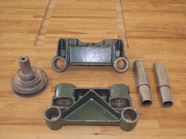

There is a thread/pictures of one someone made from hard wood. However you would still need the head stock pulley with the drive hub. The originals are very rare also. So again Skip is the source. You could also drive it with a pulley on the motor shaft but the original is even rarer than the head stock pulley. Again, Skip has that part also.
Another option is make a bench top stand and get a 1/2HP motor and drive it that way.

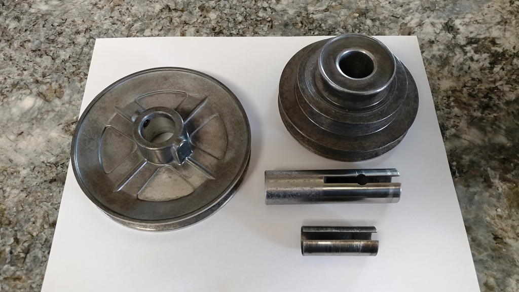

I actually have the original (does not mount on tubes).

Yeah, I'm still learning all of the differences. Now that I'm looking at it I'm not sure it would even be able to mount to the modified table without modifying the actual jointer itself.
I may need to investigate this some more.

It appears I'll need the extra 5" pulley as well....
Re: So I have this jointer attachment...
Pictures of what you have would really help.Ek1050 wrote:Yeah, I'm still learning all of the differences. Now that I'm looking at it I'm not sure it would even be able to mount to the modified table without modifying the actual jointer itself.
