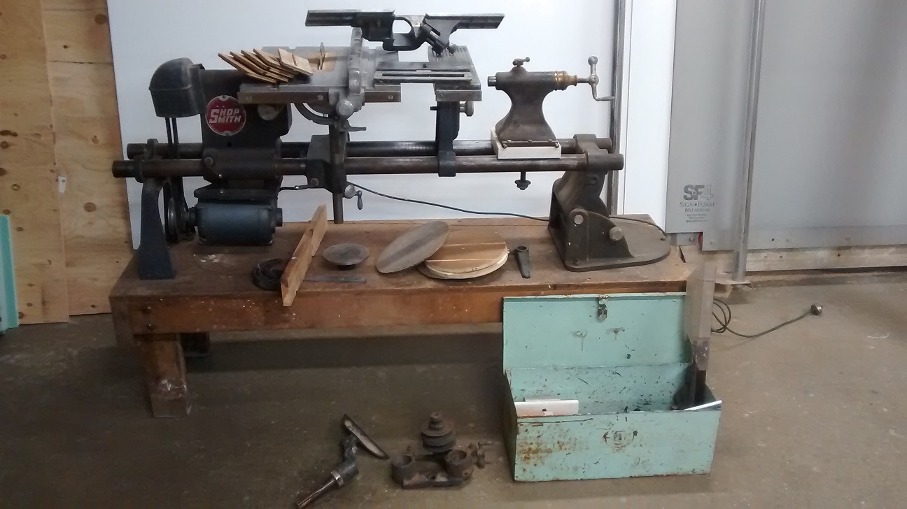

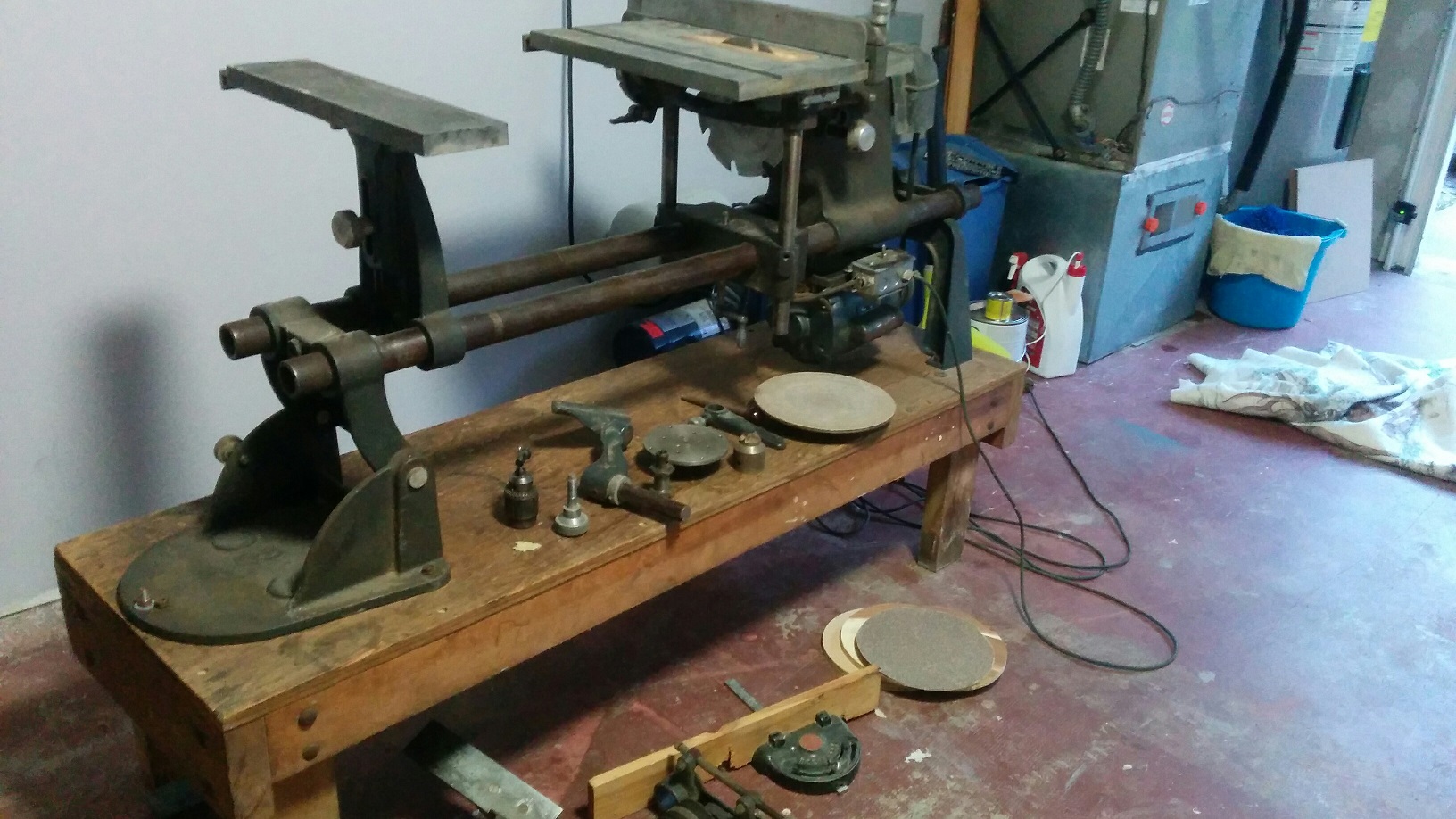

I think I have come across a SS that was before the 10E and 10ER.
It was given to me by a friend who's grandfather had it. It says simply "Model ER Serial number ER22221"
Looks like it came with a wooden stand (or it came with none and someone built it)
It runs, but I'm going to restore it. Anyone know where I can get a manual? Maybe a 10E or 10Er would come close. This also has the "speed changer".
I have the Mark 510 with the new electronic headstock, and want to restore this one for my son
The First Shopsmith

How did you come to that conclusion?Emil wrote:I think I have come across a SS that was before the 10E and 10ER.
There was no SS before the 10E. The 10E's came out in 1947. Yours says 10ER. They came after the 10E. By the serial number it was made in March of 1950. No Model 10's came with a bench or a motor. In the beginning Magna provided a blue print for a suggested wood bench with each machine. Later they came out with a set of metal legs as an extra cost accessory and then a set of retractable castors for the legs. You had to supply your own wood for the top and assemble it yourself.
As for the manual, you need a 10ER manual. It won't be close it will be exact. They are on eBay all the time if you want an original. Otherwise there are numerous sources of a PDF copy.

Welcome aboard.Emil wrote:I think I have come across a SS that was before the 10E and 10ER.
It looks to be in great shape, although the speed changer seems to have a piece missing from the casting. The tailstock in the first photo is not an original Shopsmith part.
The bench is made per the blue prints that came with it when new.
You can download manuals from VintageMachinery. http://vintagemachinery.org/mfgIndex/de ... =338&tab=3
And there is a great 10e/er resource thread on this forum that should get you started. http://www.shopsmith.com/ss_forum/viewt ... 972#p57972
Have fun, they are great machines,

The miter gauge is 'unusual'.
