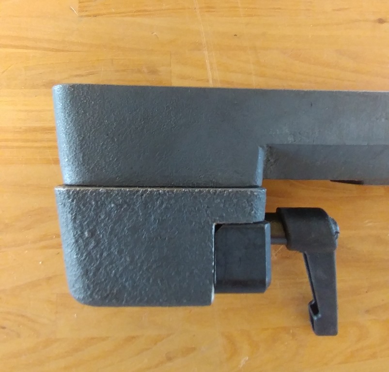

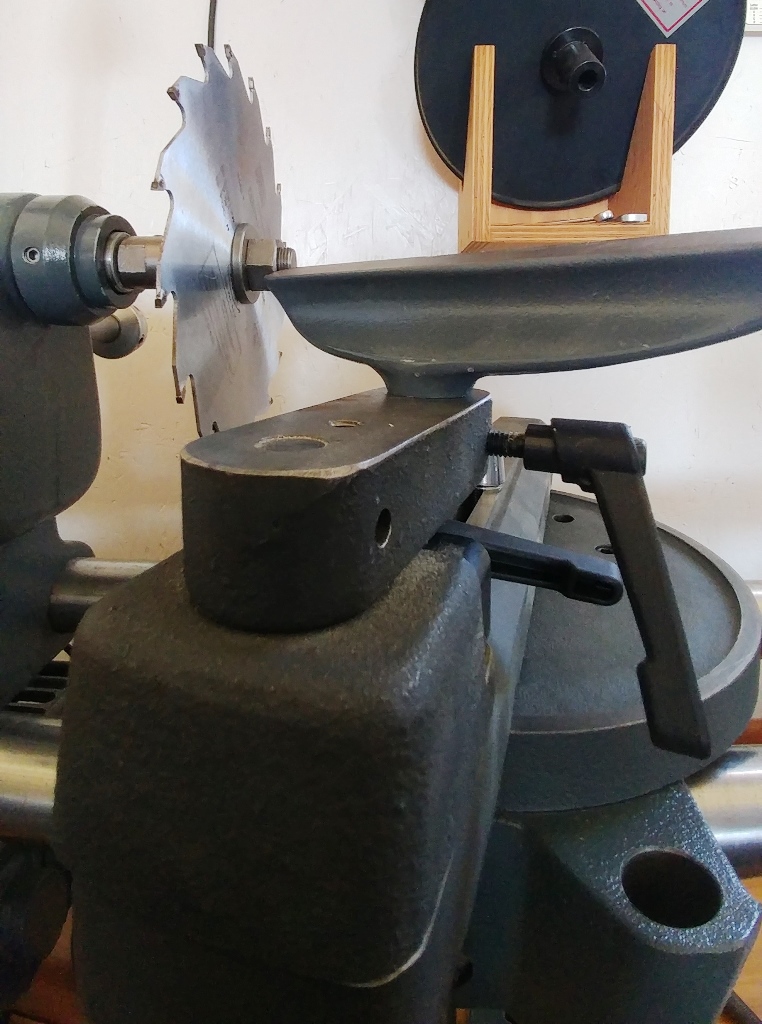

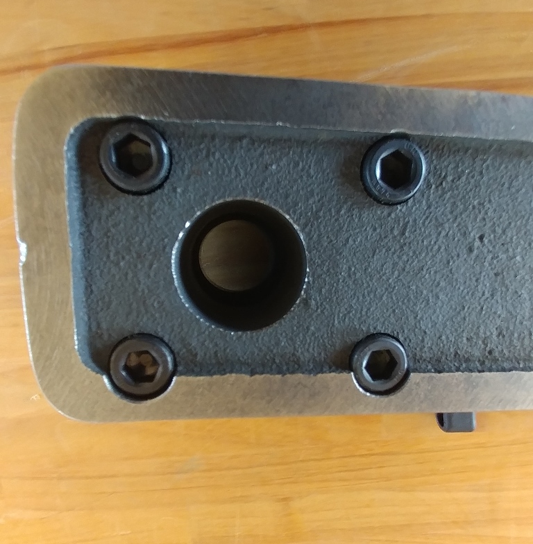

OK, here is the answer as I see it. The UTR will work fine with the 10ER. First the bolts have enough threads to attach the base plate to the carriage. No need for shorter bolts. There are a couple of ways to go for the tool rest itself. The 10ER straight tool rest I have is just below center using the short stubby arm that comes with the UTR (first picture). The long straight MK V tool rest and the short straight tool rest that comes in the specialty tool rest kit are both slightly above center. The 90* and S shaped tool rest from the specialty kit are slightly below center.
The tool rest posts are 3/4" and the post that attaches the short stubby arm to the main arm is 1". The first thing you could do is loose the short stubby arm. That would gain you an inch but you would have to buy third party tool rests with 1" posts.
The best and easiest option is to remove the cast iron block from the end of the large arm. (second and third pictures). That will gain you 1 1/2" and you can sill use the short stubby arm and SS tool rests. The only thing that would have to be done is drill and tap the large arm for a set screw to lock the short stubby arm in place. To me that is the solution and it should work perfectly.
