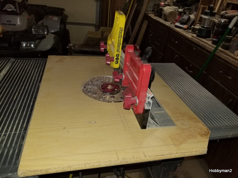

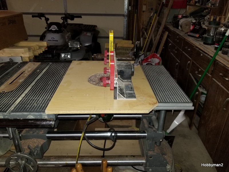

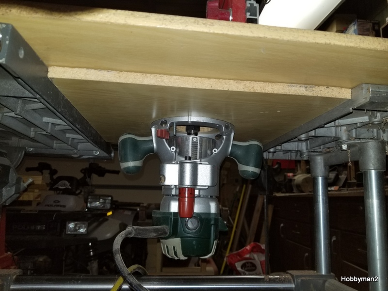

I built this a long time ago and it seems to fit perfect in the SS so I could say it is for my ss , not as nice as others ,,,but it works great and the ss table system makes it even better then the way it was before , clamped to a set of saw horses.

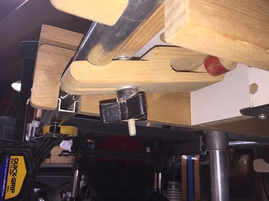

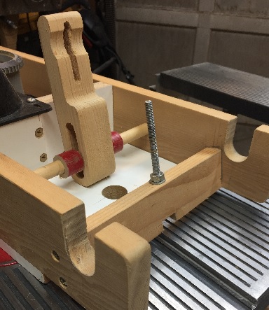

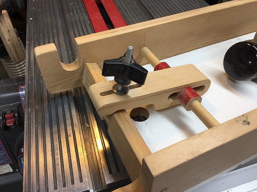

Underneath are sliding brackets so I can drop it on the tubes and then clamp it. The cross-piece of the frame is tilted in 20 degrees so the bolt is perpendicular to the clamp when tight.
2 Bracket.jpg (91.46 KiB) Viewed 19199 times

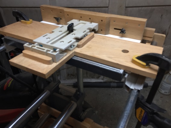

Here it is clamped. When loosened, it slides just far enough to clear the tube so the table can be lifted off.
3 Clamped.jpg (69.23 KiB) Viewed 19199 times

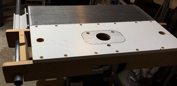

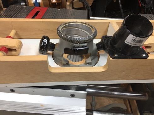

The front edge is notched to provide better access to router controls. Mounting a dust port was an afterthought, but it captures a decent percentage of sawdust.
4 Front.jpg (68.97 KiB) Viewed 19199 times

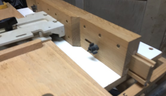

My fence has a $30 Rockler/Incra jig mounted on a pair of boards half-lapped together. It is wide as the table for easy clamping.
5 Fence Back.jpg (68.5 KiB) Viewed 19199 times

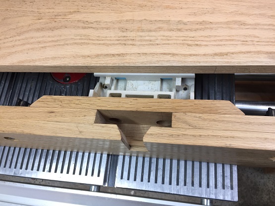

The back side of the fence has slots with knobs on each side for adjusting the bit opening on the front.
6 Adjust.jpg (44.42 KiB) Viewed 19199 times

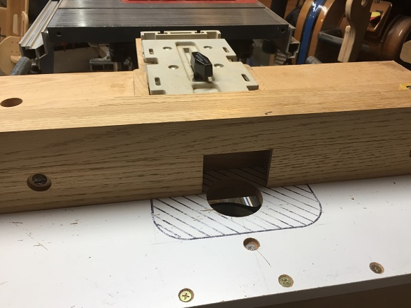

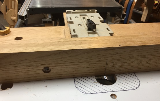

The face has a fixed top half and split bottom half. Here the bottom is opened for a wide bit.
7 Wide.jpg (81.51 KiB) Viewed 19199 times
Here the bottom is closed for cutting slots and grooves. A narrow or closed opening prevents the work piece from tipping into the bit opening. I can adjust for any bit size.
8 Closed.jpg (68.8 KiB) Viewed 19199 times

That clamp is really fantastic looking but, and I hate to admit this, I can't get my head around why the frame cross piece needs the 20 degree tilt.
moggymatt
Posts: 638
Location: Spokane, WA
Re: Show me your custom router table for the Shopsmith
Post by moggymatt »
Rickster, great setup. I like that clamping solution as well. Now that I've got a 520 I'll have to build a new router like that. Currently my router table was built to bridge my 500 tables or a set of horses.
Paul B
Rickster
Bronze Member
Posts: 5
Joined: Sat Apr 01, 2017 12:37 am
Post by Rickster »
Regarding your question on the 20 degree angle: the angle is determined by the hinge location plus the angle of the clamp when it is tight (the prior photo shows the clamp is at a slight angle). In the photo below with clamp out of the way, you can see the clamping bolt. The end-piece is notched on top to countersink the bolt head. My first attempt had a normal, straight end. When I tried to tighten it, the clamp was at an angle to the bolt and it didn't tighten well. So I made a new end with a bolt through it, hand-held it in place, and twisted the end until the bolt went straight through the clamp. It just happened to be 20 degrees. If the hinge was further from the table, the clamp could be straight on the tube and the end-piece could be square. I made the clamp out of a 6" long 2x4 scrap. I drilled a one inch hole that became the curve that clamps to the tube. Then I routed 2.25" long slots for the hinge and bolt. The last step was cutting out the shape and sanding. The hinge is a half inch dowel and red pieces are scraps glued to the dowel to keep the clamp centered on the hinge.
While I'm thinking about it, here is the bottom of the fence. It needed a hollow space behind the face for bit clearance. I found an angle on sliding panels allowed adjusting closer to the bit. A third piece of 1x4 on the back holds the fence together and adds enough thickness to keep the fence square to the table.
