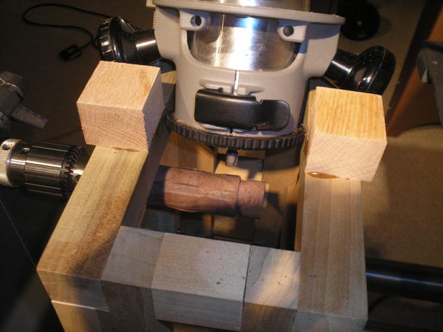

OK, maybe this small result didn't ENTIRELY justify all the time I spent on it....

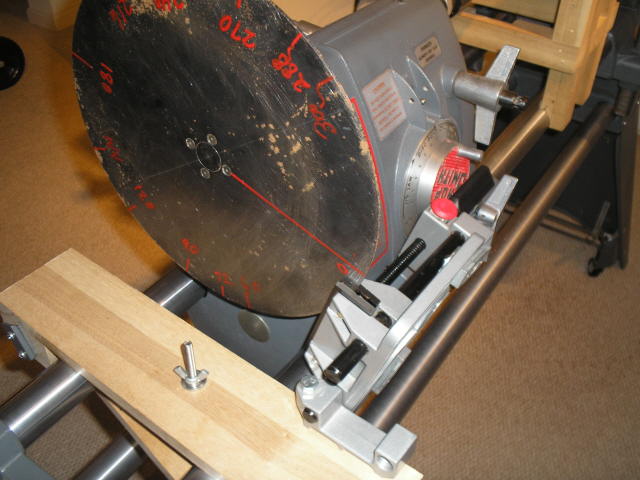

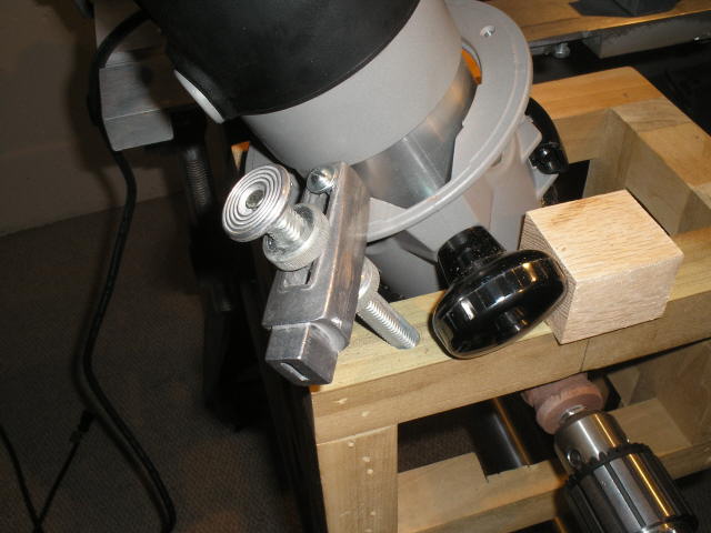

I found (in a trash-bin) a poplar carcass/jig of some sort at work. I got it home and realized it MIGHT make that router jig that's been rolling around in my mind. That is -- something to "flute" my next wooden screwdriver.
The jig DID fit on the Mark V way-tubes after a little work. It DID slide nice. It DID nicely accept a PC690 router after I assembled the router backward in the base. And the universal Shopsmith Vise and Sanding Disc DID make a nice easy indexing system.

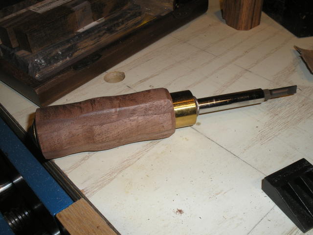

So here's the photos -- after a day of rest I will sand and finish this guy.

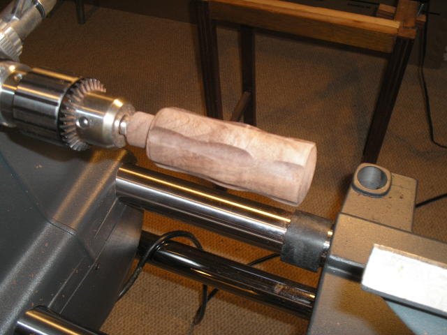

P.S. I altered the screwdriver assembly sequence to glue in the metal shank before the turning work was all done. This made it firmer when it was only supported on one end for the fluting operation. (I wouldn't want to do much longer of a workpiece without getting support on the other end.)

I like your ideal but I have seen a few accidents with routers. I don't want to sound like your mom but be careful. 30,000 rpm isnt something to mess around with. You can easily build or buy a nice router holder. Here is a link for buying http://www.k2cnc.com/shop/products.asp?cat=31 Either way have some safe fun with the new jig. Something to also think about is live tooling lathe functions. Brings a whole new level of Turning. http://www.youtube.com/watch?v=eJ7NYL0HnsQ

You know -- there are a couple of Sears router-crafter jigs on the used market not far from here. I may well get one some day. Looks fascinating....
As for the jig I made myself, thanks for the cautions. I did go very very carefully and that router is mounted in an extremely stout way, surrounded with a wood cage. I also used quite light cuts to flute my screwdriver, such that the router really didn't even change speed. All this being said-- it's a very specialized jig that I'll only use for 1 or 2 types of tasks. In fact it is so specialized that it works smoothly on my model 500 way-tubes but tends to bind on my 510 way-tubes. This is because I fine-filled the 'coves' on the bottom of the jig to exactly match the way-tube contours. (I filled the coves with J-B Quik while the way-tubes were protected with 1 ply of wax-paper.)

I Like the way you used the sanding disk as an indexing jig. I have often wondered why SS didnt offer a pre-drilled disk for just this purpose. The disk could have a few concentric circles of holes with say one circle having holes spaced every 10 degrees and another circle with holes at 15 degree intervals. The indexing pin would be mounted to the tubes and could slide somehow to allow acess to all the holes. I have even thought about buying a disk and having a local machine shop drill out the holes and then rigging some kind of index pin myself. Up to this point, though, this project has been one of those "maybe later" ones. Seeing the way you used the sanding disk reminded me of it. Seems like it would be a pretty easy accessory for SS to manufacture and I would certainly be tempted to purchase one from them if they did offer such a jig.
BTW...the screwdrivers came out great! Thanks for posting the pix.
