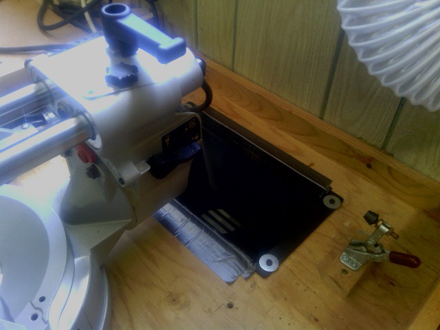

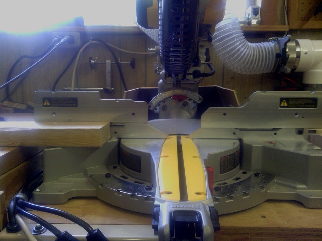

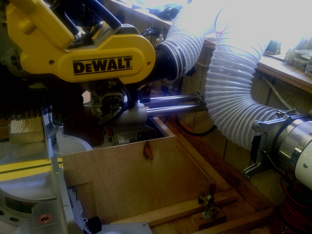

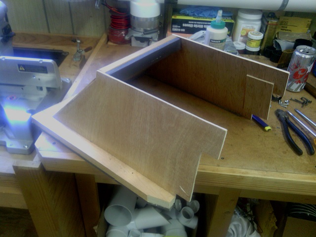

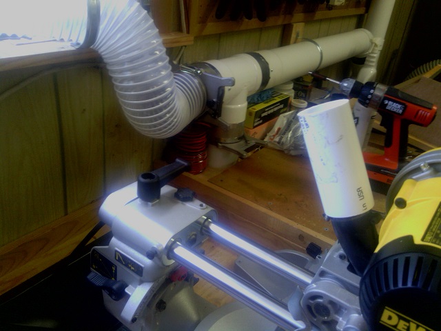

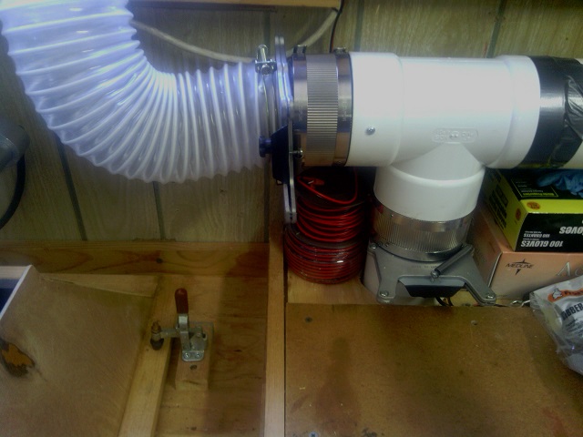

Dust collection for your miter saw is a must have, it is the worst offender for dust. I have a Harbor freight DC...took a little trial and error but I finally found a pretty good solution. I have two four inch hoses going to my CSMS, one comes from underneath into a big gulp and a hole in my table behind the saw with a hand made removable (held in with toggle clamps) low hood if you will, works basically like a down draft table, the second goes to the saws normal vac hose port, stepped down from four inch, used a small piece of pvc to slip into a reducer. The reason I have two outlets is because I have to remove my down draft hood if I have to rotate the saw to 45 degrees, only the top portion is used, not as effective as using both, but better then nothing. Yes I have to open two blast gates, but that is a minor inconvenience. Few pics to give you an idea of what I am talking about, works very good, getting about 380 cfm lower and 200 cfm or so top port, because it gets choked down so bad, but both turned on I get 90% or so collection.

I also might just have to incorporate a dust collector pipe system into the miter station, because wow that looks slick. With that larger hole below, I am guessing the 330 CFM on the DC3300 may not give it enough suction. So I might be best to stick with the jet 650 and go around plugging it into whatever tool i need it on. However, building the piping into the miter station with a 4" inlet on the side of the miter station would at least simplify the hookup on a regular basis since the collector will be making it's rounds then.
