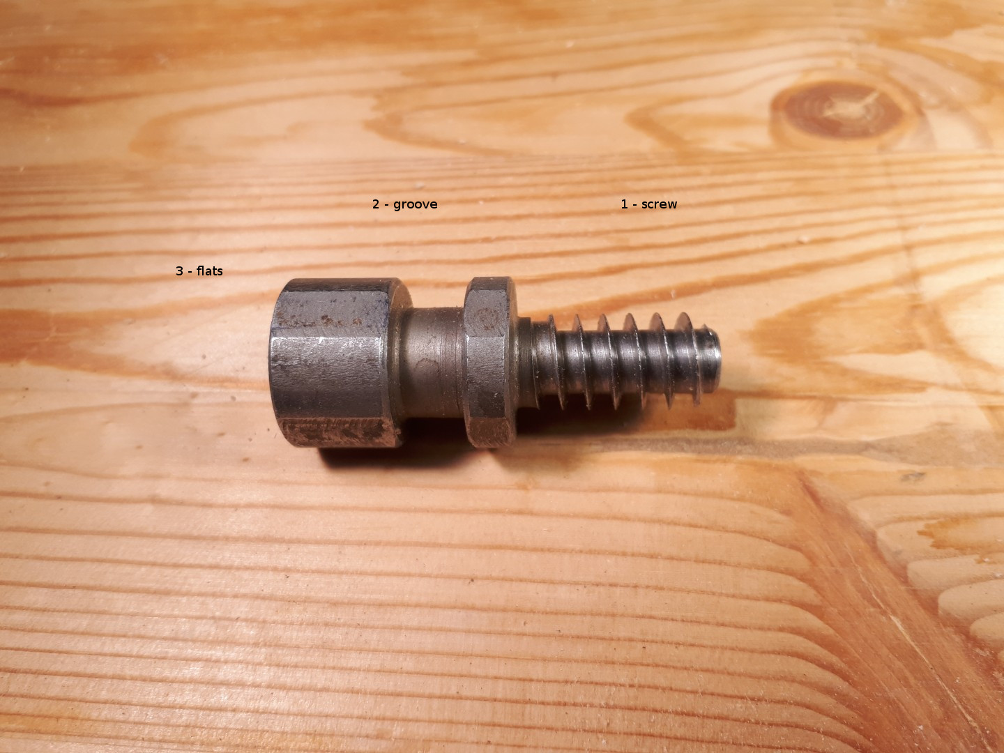

First lets look at the parts.
The woodworm screw has three sections.
1 - the screw - where the work-piece will mount.
2 - the groove - the inner edge of the jaws will sit in the groove to prevent movement along the axis.
3 - the other end - note the four flat areas, the inner end of the carriers (the parts that the jaws mount onto) on the chuck will clamp there.

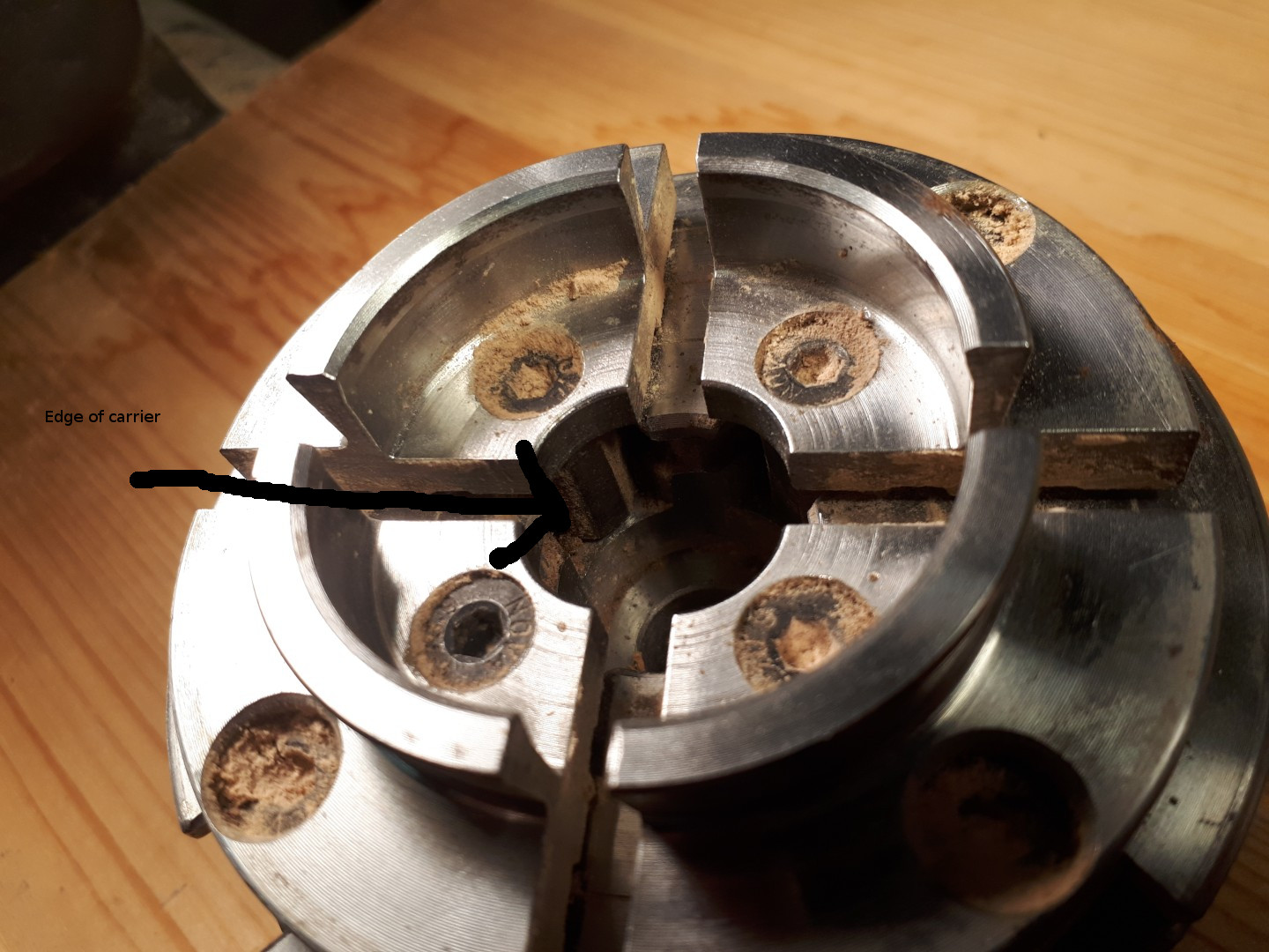

Here is the chuck
Note the inner edge of the jaws and the carrier.

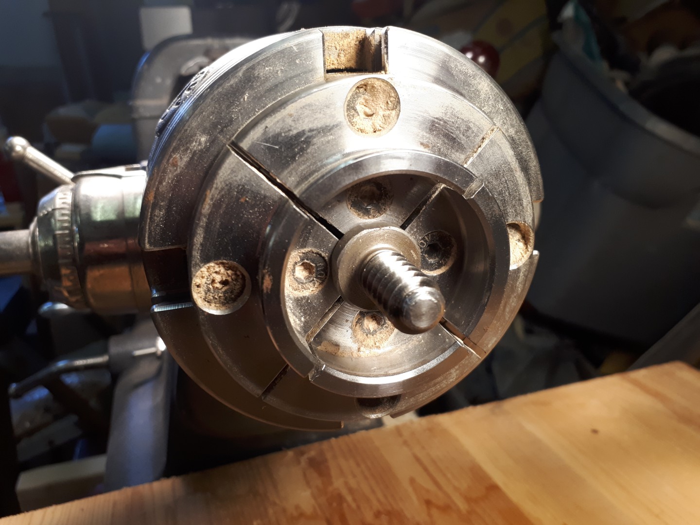

And here is the woodworm screw mounted in the chuck,
Note the edges of the jaws nested in the groove and the flats line up with the jaw mounting screws.
So the procedure is
1 - insert woodworm screw in chuck with inner edge of the jaws lined up with the groove.
2 - slowly tighten while turning the screw back and forth so that the inner edge of the carriers will align with the flats
3 - mount the work-piece on the woodworm screw and tighten till the back face is tight and flat against the outer face of the jaws.
if you don't want woodworm screw to penetrate that far into the work-piece it is possible to put a spacer (a disk with the appropriate thickness) between the jaws and the work-piece.
