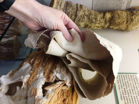

L.Officinalis
L.Officinalis
The conk of L. Officinalis, depicted in the Wikipedia reference, is the visible fruiting body. The mycelium felt, however, is only visible if you peel the rotting wood away from the tree. This interior felt is what the fungus bag is made from.
