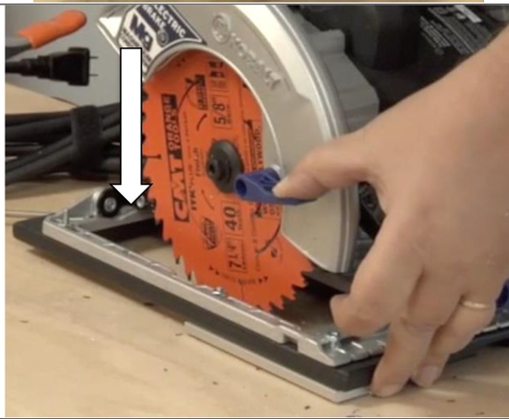

Re: Any circular saw especially good for the True-Trac system?
I don't have the system so what I did was look at the manual online and there is a picture showing the saw they used for the pictures, one could guess that would be a good choice since that is what they used??
ScreenHunter 02.jpg (69 KiB) Viewed 22154 times
