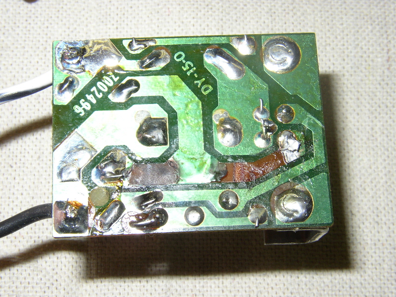

In reviewing this thread, I think you have been given the full range of advice - from replacing the box ($$$) to trying to repair the board, or the components. When earlier, I suggested you call Shopsmith, that is still a good idea. You never know what parts they may have without asking.
If you want to repair the board, as suggested, you might be able to do that. Use small gauge wire to jump (shunt) the broken parts of the board. You can find breaks by attaching an ohm meter and wiggling the board. If there is any diodes on the board, you will have to be careful not to heat them up with your soldering iron. If possible find another place on the board to complete the broken circuit. Just use enough heat to get a good contact at jumper wire connections.
I recently repaired a small battery charger by installing two jumper wires to shunt over broken parts of the board. I've also once used a small piece of tin foil to act as a jumper.
Potentiometer or rheostats don't usually go bad unless really overheated. However they do get dirty and don't resist evenly through their range. A cleaner available from a radio repair house will help a dirty one. Also these things can be replaced fairly easily.
I still think that a $200 part from SS would still give you a bargain priced Pro Planer. As told on other threads these are very high quality machines.

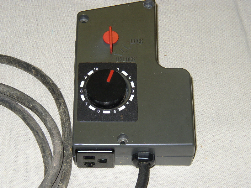

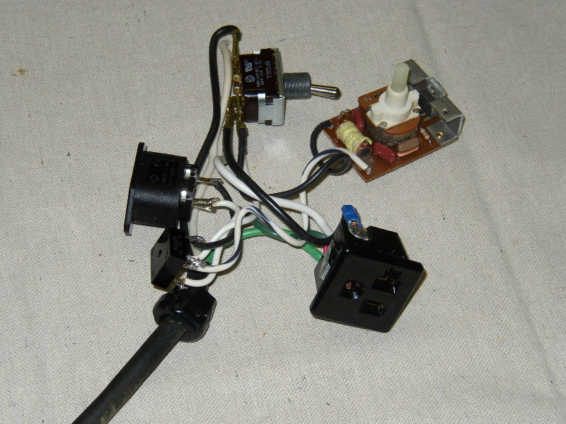

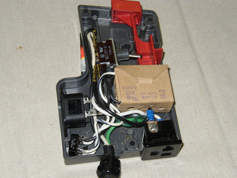

I took some pics of the control box and circuit board.
tdubnik
Posts: 545
Joined: Wed Nov 12, 2008 8:04 am
Location: Talmo, GA
Post by tdubnik »
[ATTACH]2354[/ATTACH]
[ATTACH]2355[/ATTACH]
[ATTACH]2356[/ATTACH]
[ATTACH]2357[/ATTACH]Pictures of the culprit.
