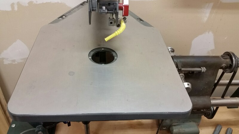

My Shopsmith scroll saw is fantastic in that respect, it never has an orbit, and cuts every bit as good as the Dewalt. Problem is its an attachment model which means extra noise, not as "easy" to just go to it and scroll away. But my biggest complant is the table, the aluminum always leaves black marks on the back side of what I'm cutting. So I sort of haven't been going to the shopsmith.

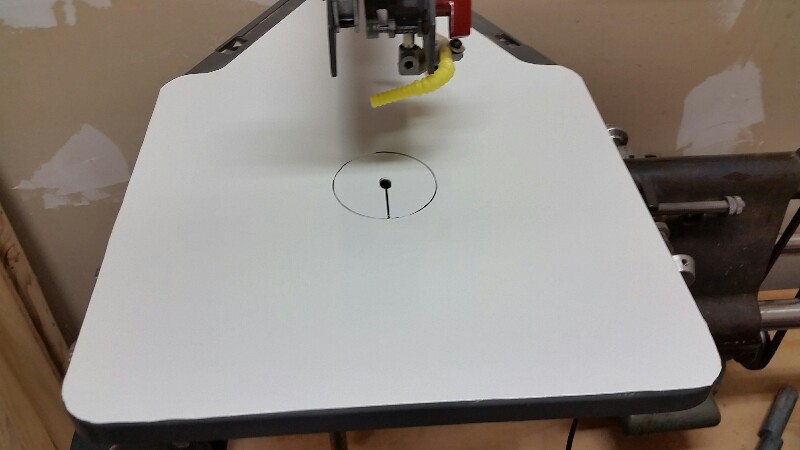

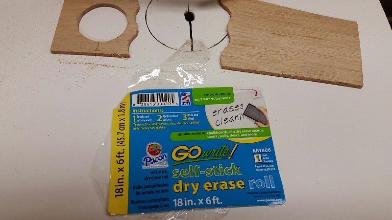

I use these stick up white board rolls a lot at work and thought I'd give it a try on the scroll saws table. There 20 some odd bucks for 2 at Office Depot or Staples and wider than the tanle and 6' long, so it's a super cheap solution. Easy to trim with an exact knife and it makes a world of difference.
HUGE Scroll Saw improvement
- Attach like wallpaper
- 20180210_100323-800x450.jpg (46.49 KiB) Viewed 19766 times
- Here it is
- 20180210_100510-800x450.jpg (80.32 KiB) Viewed 19766 times

Those black marks of which you speak, I see them when I have neglected to keep my waxing of the table. I get them most often on the table saw where I've been doing a lot of cutting but not waxing as often as needed. I have never seen the marks on a well waxed table.

Stopped at Staples. The "only" thing they had like that was a Martha Stewart thing for $40???? Well I came back home without it tempting as it was. Didn't find the post-it tape either........ so it was pretty much a waste.
Amazon on the other hand has the same stuff:
https://www.amazon.com/GoWrite-Erase-Se ... erase+roll
So I'll just order it from them. They also have the tape my wife wants.
Re: HUGE Scroll Saw improvement
Sorry you wasted a trip but once you get it I think you'll like it if your using it for a lighter duty table cover. Its holding up great on the scroll saw. You'll have to share what your using it with though.reible wrote:Stopped at Staples. The "only" thing they had like that was a Martha Stewart thing for $40???? Well I came back home without it tempting as it was. Didn't find the post-it tape either........ so it was pretty much a waste.
