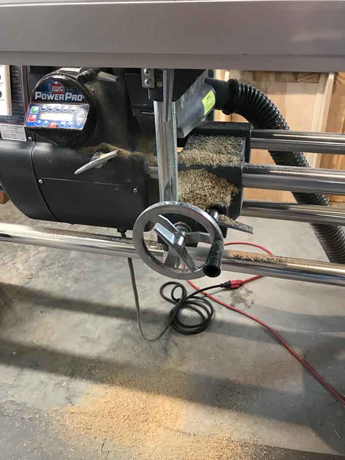

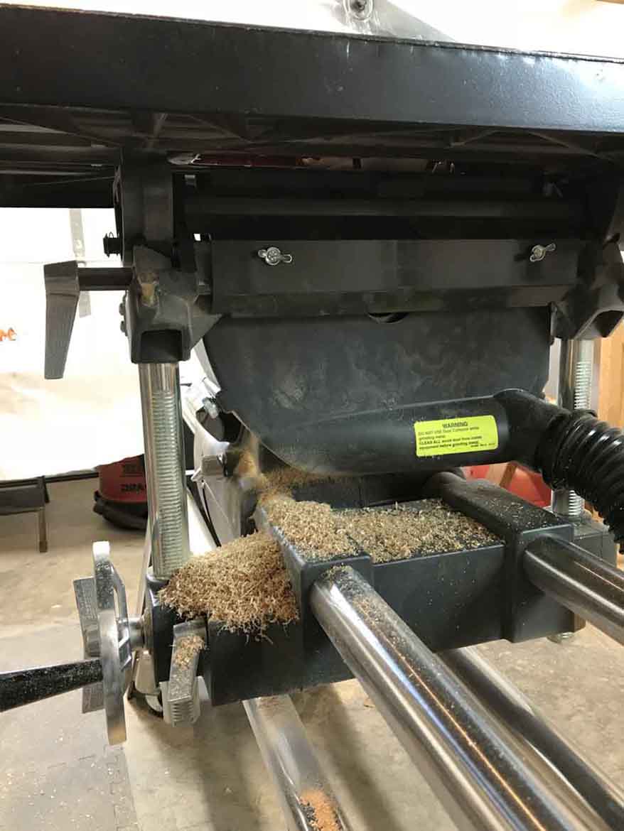

Quick question about dust collection. I have the Shopsmith DC3300 dust collector hooked up to my Mark 7, but after just a few cuts on the table saw I have a pile of sawdust under and all over the machine. Is this normal? I've never used any other small-shop dust collectors (just an industrial version at a big shop where I used to do some work), so I don't know if this is just a fact of life in a home-based shop or if I'm doing something wrong. The dust collector seems to have good suction because I put the brush on it and use it to clean everything up after I'm done, but for some reason it just doesn't seem to be pulling in the dust while I'm cutting. Seems like maybe I have the blade cover adjusted wrong or something.
- Dust piles up after every cut.
- Dust Collection Fail 1.jpg (76.01 KiB) Viewed 32721 times
- Dust Collection Fail 2.jpg (64.77 KiB) Viewed 32721 times

That's normal. It's not a lack of dust collecting power. It is all the gaps in the lower saw guard. The biggest source of escaped dust is top dead center of the lower saw guard between the guard and the bottom of the table. Then the right side of the guard (as you stand in position to operate the machine) and the bottom of the table. I find that opening the lower saw guard as wide as possible helps a little. Others close it down as much as possible.
You can make temporary or permanent modifications to the lower saw guard to add deflectors to close off the gaps that let that sawdust escape. You can search the forum and will find several threads discussing the issue. If I can find the links, I will post them here.

Thank you! This is a great tip... I'll try to make a deflector like the one in your link before my next project!

It doesn't look like you have extended the lower saw guard all the way out to mate against that vertical plastic piece with the wing nuts.(1st pic)
There are 2 knurled round knobs that you loosen, then push the lower guard out to bump against that vertical piece, then they are tightened down.
