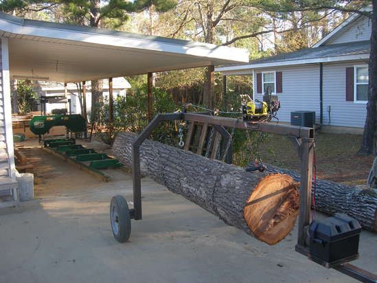

I've been working on this one in my head for a while now but the time as come that I need it built.
What I'm building is very much like the one in the picture but heavier and with bigger wheels and hubs and length sized for 20' logs. It needs to be wide enough to easily straddle the sawmill. It's pretty simple really. I have an empty pallet ready to gather the components on to start building it. Some of the parts I have saved for years for it. The wheels, hubs, spindles and lower frame sections are from a scrapped 12' Kewanee farm wheel disk. I have heavy steel rectangular tube for the bulk of the frame and I already have 2 winches for it.
That is not my sawmill in the picture but my configuration is a bit similar. I'm moving my mill into a smallish garage about the size of that carport that has a garage door on one end and I need to add a little onto the back end for my longer bed (21') and add a garage door there. That arrangement then needs the log arch for log loading from the end.
I'll probably not move the mill before I cut this next batch of lumber but I also need the log arch to assist in getting the logs out of the woods without dragging them through the dirt and gravel (bad for blades) plus I have a rather pesky hill to deal with and the arch will be much safer than dragging logs. Once up the hill and back in civilization :) I can just back the log arch up the ramps of my old backhoe hauler and position the logs as needed. I have a 10,000# winch on that trailer that I can use if needed.
Sawmill - Log arch.jpg (42.88 KiB) Viewed 2989 times
