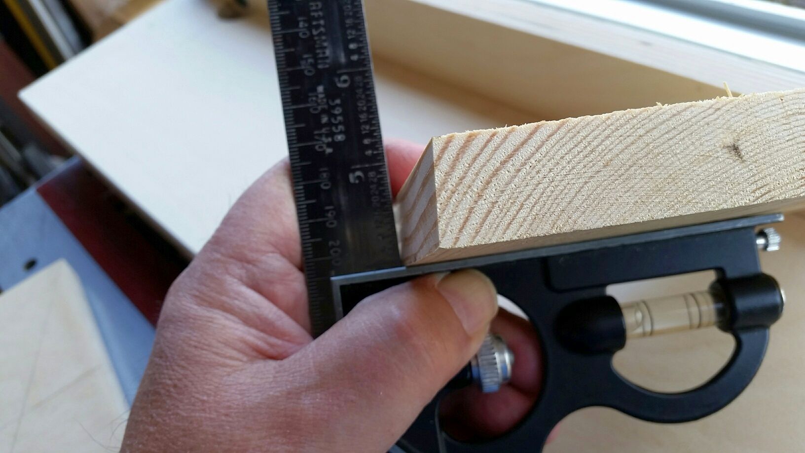

I was working on a birdhouse and using the GWSS to make the cuts. Since I had no idea of the angles and since I wanted to do a bit more on the project and I want to see how the GWSS might work for angle cutting........ This is for the bottom of the birdhouse and yes it doesn't really need to be done but it was an excuse to play.
So I guess most of you know that sometimes for non critical times you can simply put the bottom of your angled piece that you want to match on the main table then tilt until the angle of the table lines up with the angle on the work piece. Except in this case the secondary angle doesn't let you do this well. So time for a little trick of the trade.

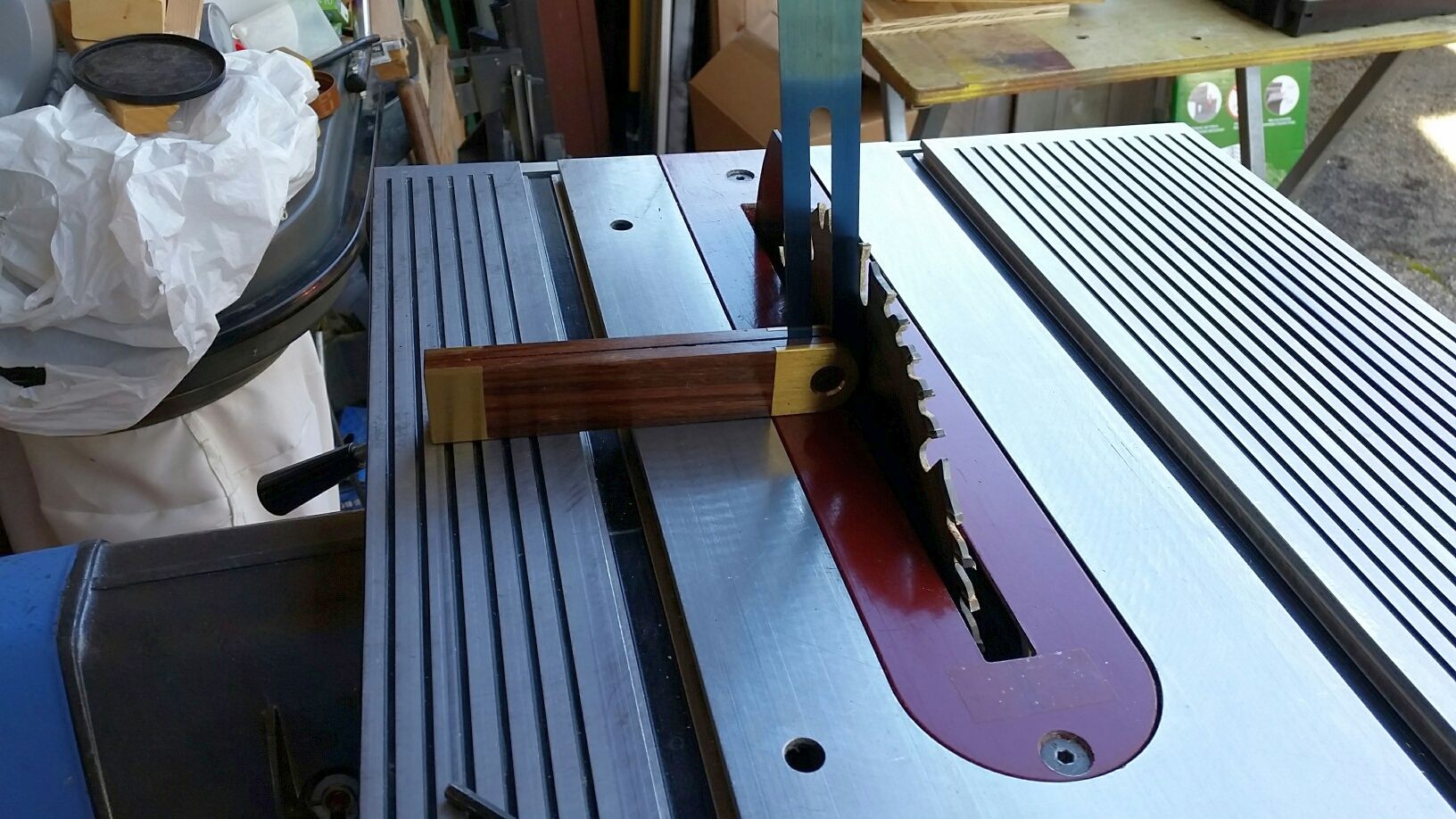

Then you can transfer the angle to the table/blade:

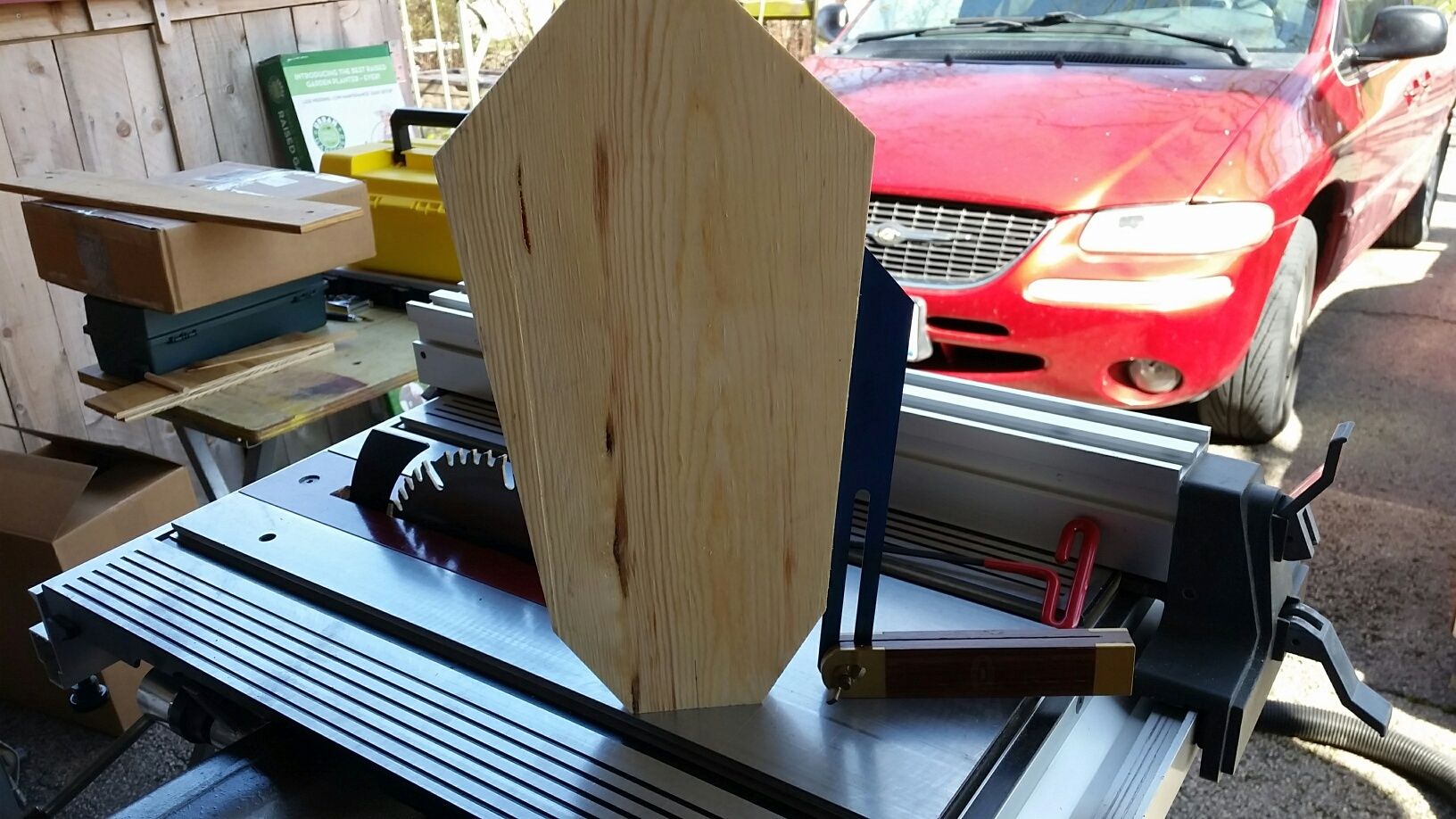

Now using the line I put on the work piece I used the GWSS to make the cuts.

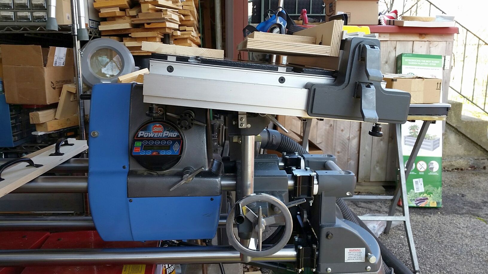

The set up:
And the results:
For a birdhouse this was more then satisfactory.
