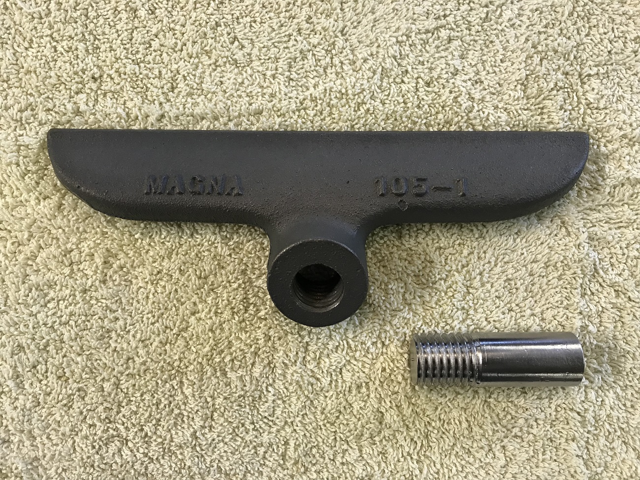

13 Different Lathe Tool Rest, has removable shaft for attaching to the Arm, later it was single Casting. Original Production models have this Tool Rest (S/N 1077)

- Tool Rest from S/N 1077
- 105-1 Tool Rest with post back s.jpg (738.38 KiB) Viewed 24616 times
