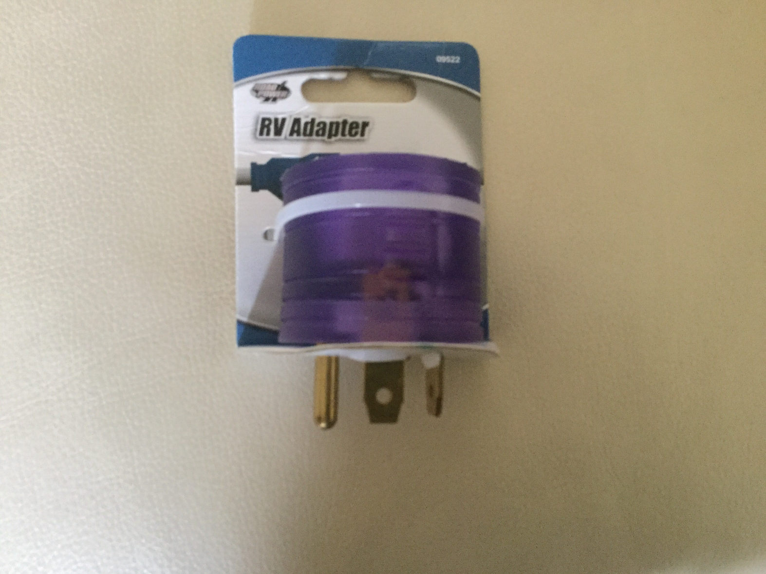

I was wasting time waiting for a prescription and wandered down the RV aisle at WallyWorld and found this

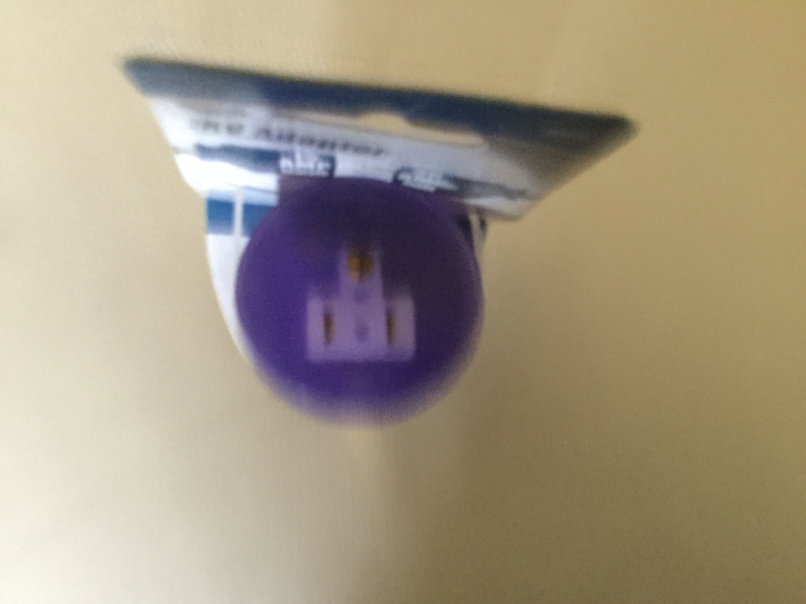

For less than $6, a no muss no fuss solution to running your PowerPro on 120 or 240. I’ve modified an extension cord, but as has been pointed out, plugging in the wrong tools can have disastrous consequences.
This is the Road Power model 09522. Wally World Id per the receipt tape is 002989209522. $5.58

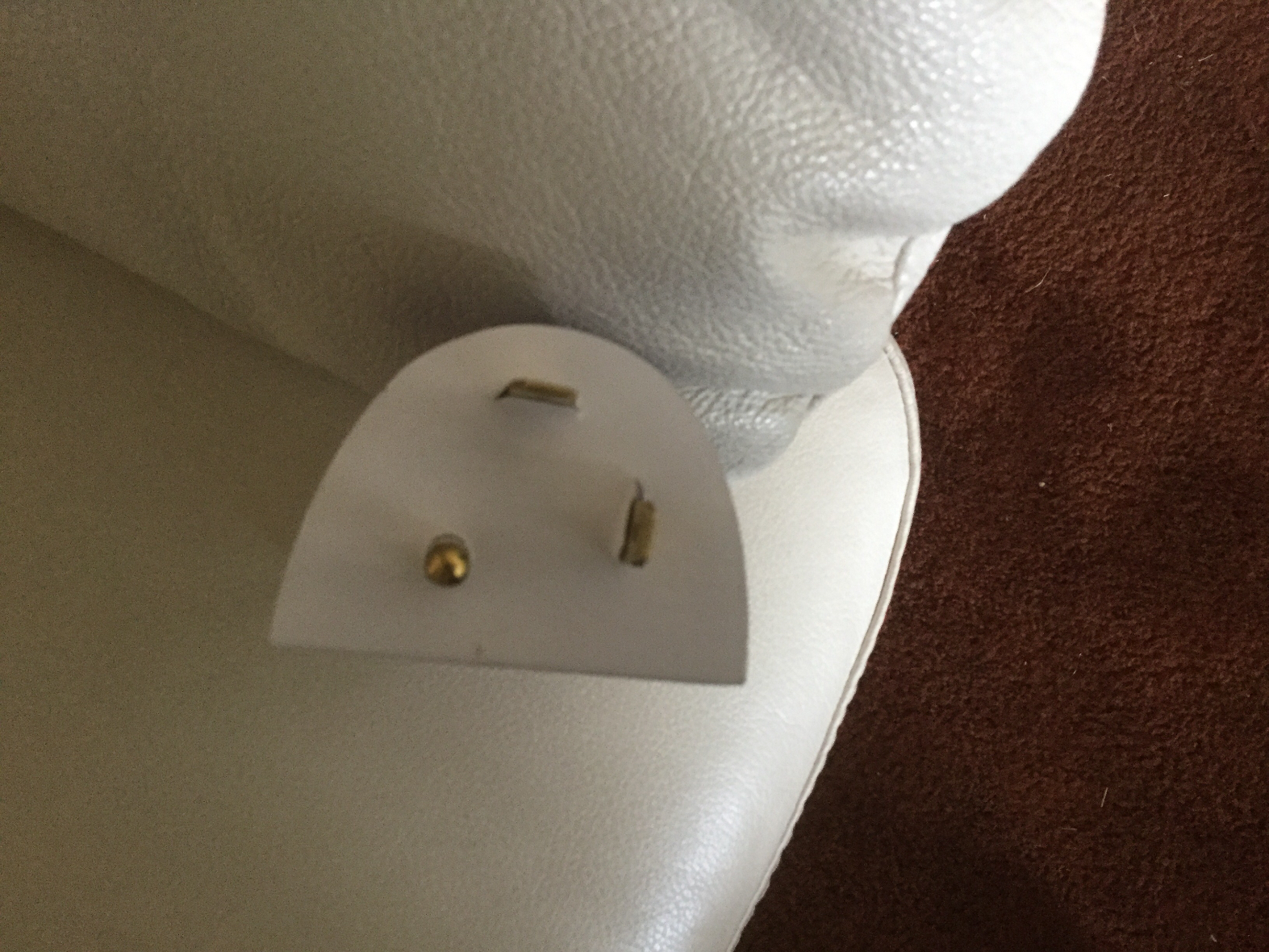

I am curious which NEMA receptacle the male end fits. NEVER MIND - TT-30

I still question how any adapter to allow plugging a 110 power cord into a 220 circuit/outlet is legal in this country.
It is not.

The RV 30A plugs/receptacles are 120V.
Yes I just now looked it up.
So for that 'adapter' to provide 230v, one would have to connect 230v to a 115v 30A receptacle (a definite "NO NO").
Hmmmm. Well JPG, I guess I stick with my cobbled cord. I didn’t bother to look on the package until your postings (I never read burgers since he is the ONLY one I have blocked.). After reading your posts I checked on the package and sure enough it has 1875 Watts max. So much for 240 . Oh well, I only lost about $6. Maybe I can dump it at a yard sale.
That is because the output(female) receptacle is rated at 125V 15A.
